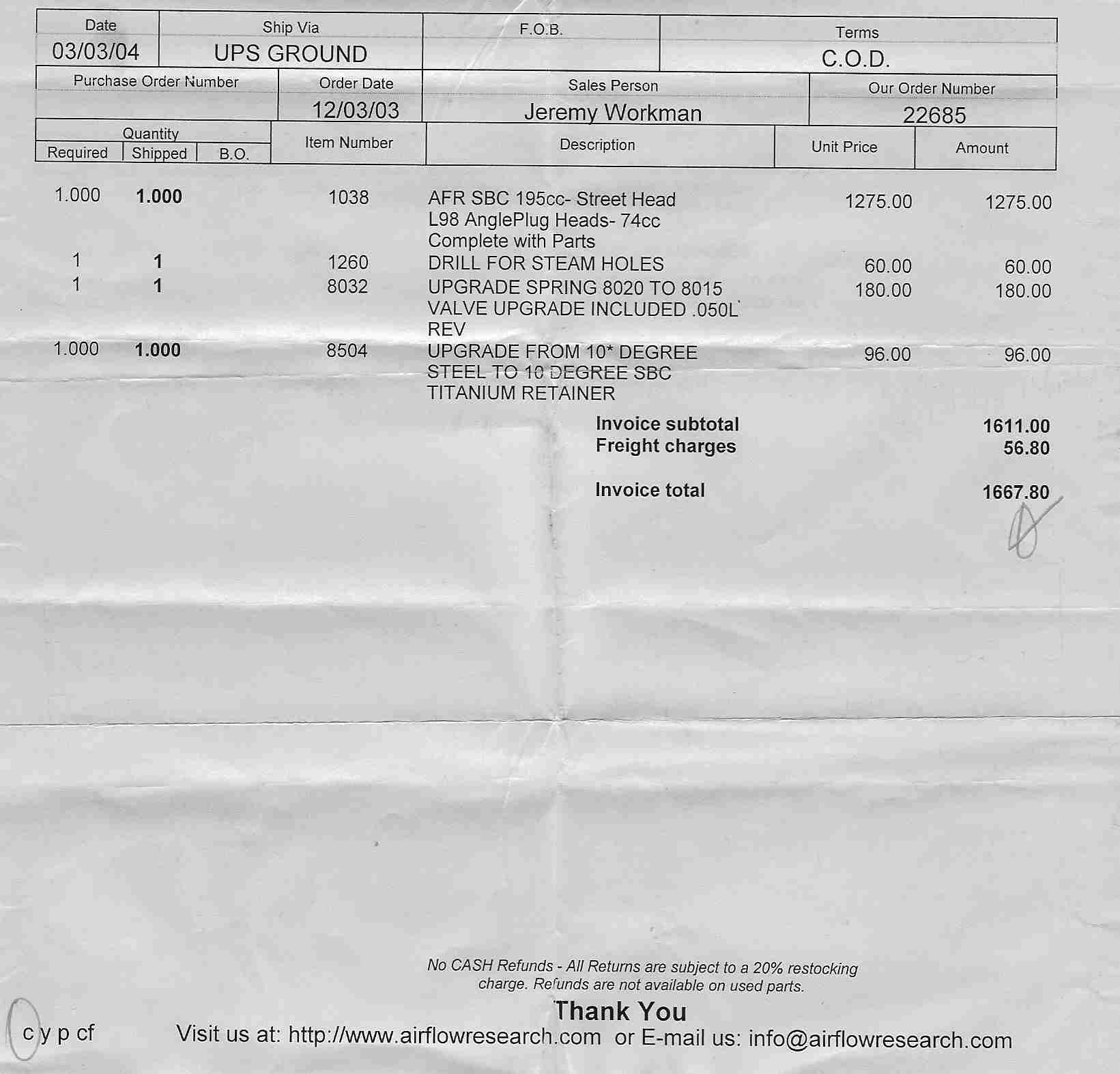

AFR makes 2 different angle plug heads. L98 and standard angle plug. Are you sure that you have the L98 angle plug version?
When I purchased my heads from AFR they asked me what headers I was goin to use. I told them 1-3/4 SLP's. They told me to use the L98 version heads would work better with the SLP's because SLP designed those headers around L98 heads. I have been using full size autolite plugs #3923 with out a bit of problems or clearance issues.
I hope this helps and good luck

thats the thing though they are l98 angle plug heads. I bought them used and got all the papper work with them. I checked the numbers and everything to make sure they are the l98 angle plug heads. the odd thing is how it is really just that one plug that hits. the rest are very far away. it's like the original headers are just a little differant or something.
I dented the tube and now it clears but, I might try and get the shorty plugs for added boot clearance

here shows l98 angle
Attached Thumbnails afr 195 heads w/l98 angle won't fit with slp 1 3/4 headers?-c-documents-settings-cameron
