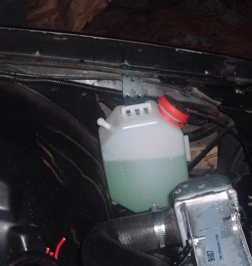

I mounted my $7 parts store plastic one on the driver's fender, close to the horn.
Did'nt even have to drill a hole to mount it. Just took out the stock fender bolt, slid the mounting bracket in between the two walls, and put the bolt back in
Ran a good rubber hose (not the thin windsheild washer stuff) from nipple on rad, to in front of rad, zip tied it to the core support, then through a hole in the side of the core support, behind headlight, and over to jug. You only see about 4-6" of the hose. The part that goes from the rad to the core support
Attached Thumbnails catch can location-c-documents-settings-john
