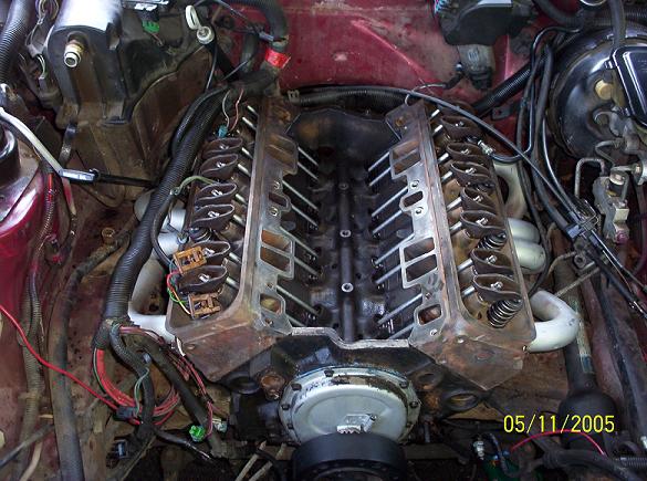

Well, i have finally had some time to do some more work to her. This is taking forever, hopefully ill have her up and going in a couple weeks.
Attached Thumbnails Progress Pics of Cam, heads, intake, carb swap, and a few questions.-progress-pic_8.jpg

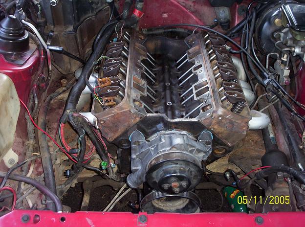

Posts: 1,101
From: Kingsport,tn
Car: 1991 camaro RS
Engine: 305 Carb
Another
Attached Thumbnails Progress Pics of Cam, heads, intake, carb swap, and a few questions.-progress-pic_9.jpg

lookes really CLean man!!! Great job on this bro Keep the pics coming

those heads don't look like they got any paint on them.
Old May 11, 2005 | 09:41 PM
  #59
del91_305's Avatar
Joined: Dec 2002
Posts: 1,101
From: Kingsport,tn
Car: 1991 camaro RS
Engine: 305 Carb
They dont, i was afraid that if i painted them and i got paint in the ports that it wouldnt be good, plus that was a good excuse not to do the prepwork. Its been taking forever so i wanted to get the show on the road

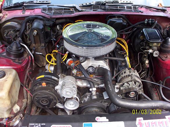

Well here she is again, its really starting to come together and starting to look like an engine. All i lack is getting the fuel lines hooked up, drive belt and a few other things here and there.
Attached Thumbnails Progress Pics of Cam, heads, intake, carb swap, and a few questions.-progress-pic.jpg

i think u need to get that nasty AC compressor out of there it will really clean the engine up and look nice
Yea, i have already planned on making that a priority.

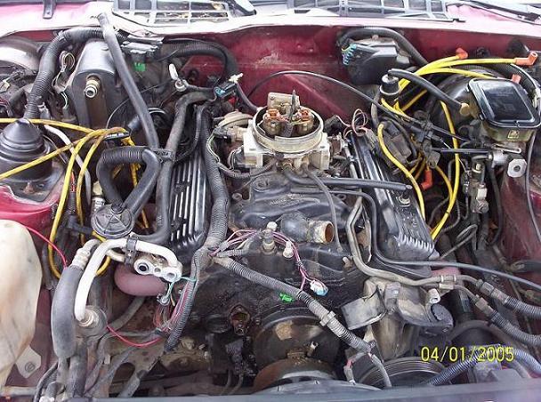

Well, i finally got her done, it looks and runs a whole lot better than before. Here is the before pic:
Attached Thumbnails Progress Pics of Cam, heads, intake, carb swap, and a few questions.-before.jpg

Now that you've got it all buttoned up:
Did you change the push rods? The roller lifter types are shorter than the flat tappet types. You can see the reason from the shot of your new lifters in the bores. If you didn't change the pushrods, your rocker geometry is going to be all off, and part wear greatly accelerated.
Yes i bought pushrods that are longer for the solid cam and new lifters
