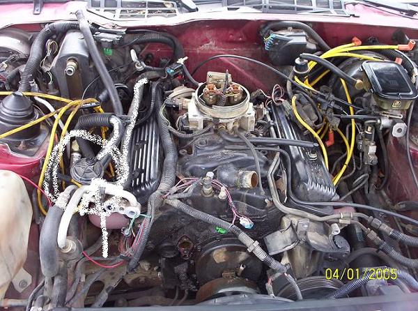

Ok for some reason its not posting my pics, it showing a link
Well, i have one question, the part that i have circled, what is that? Is there any way to get rid of it. I am trying to clean up my engine compartment, so if there is anything else in the pic that i can get rid of, let me know. Pic is in the next reply

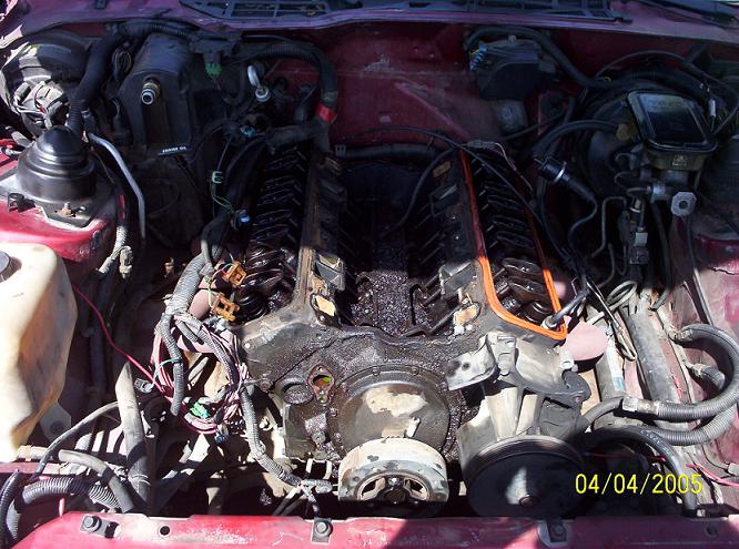

If what I'm seeing is correct, that's a LOT of gunk in the valley. Wow. Yuck.
On the lighter side of things, pull the lifters and pushrods, pop off the balancer, unbolt the cover and thrust plate and bam you're in like flint.
ps, I don't see what you circled

Yes there is alot of sludge in the thing. The part that i circled is the hose that is comeing out of the firewall from the heater core, then it comes out in that little funny box looking thing and has 2 other hoses attached to it.

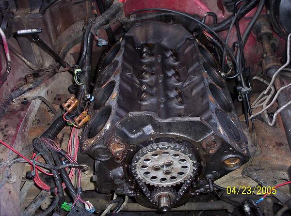

Ok heres what ive got done so far, i think all i have left to do is pull the heads, the harmonic balancer and remove the timing and cam covers and the cam should come out. Here the pic, part of it is shaded
Attached Thumbnails Progress Pics of Cam, heads, intake, carb swap, and a few questions.-c-documents-settings-compaq_owner

This is the part i was talking about that i circled. I hope you can see it now.

i think that is your thermac unit,, if i remember correctly. Not sure if it is needed or not,, i didnt have one when i bought my car, but i put it in since i had air conditioning at the time.

You circled the heater diverter valve.
BTW -- I notcied you removed your AC compressor. Hope the system wasn't charged when you did that! Speaking of which, you might want to at least tape-off the hose-bracket-thingy where the hoses attach to the compressor so's you don't get any dirt or anything like that in there. If I recall correctly, AC systems are very intolerant debris in the system.

Sancho is right, that's the heater control valve. And yes, you can delete it if you want. Here's a how-to thread about it: https://www.thirdgen.org/techbb2/sho...hreadid=242747

Sure, only problem is youll have hot coolant going to the heater core at all times.

Oh, it's not a problem to remove the heater valve. IIRC, the valve only shuts when the AC is in the Max position. A lot of cars don't even have them.

Well, im finally done with the disassembly, took me about 12 hours. The hardest part was probly getting those darn lifters out, and the passenger side head didnt want to break loose for nothing. But so far everything has gone pretty well. Hopefully the re-assembly will go just as well. Heres the pic:

I believe sludge comes from running on old oil. The person before you or you did not do the proper oil changes on this engine. I have not seen that kind of sludge in a long time. When you go to cleant hat out you are going to get alot of crap in the lifters and crank. If you dont tear that down I would at least run a few guick oil chages throught it and maybe a quart of tranny fluid in the oil to help clean it up. you hae your work cut out for you but you have to GITTUR DONE

Man, that sure is a lot of sludge in there. What kind of oil have you been using? I haven't seen that kind of crude since the 80's.
That looks like vintage Penzoil buildup. back in the day of 3rd gens, a car with Penzoil + infrequent oil channges = sludge. But now they got the better Z3 detergent additive or something like that.
Remove and clean the cover from the bottom of your intake manifold if it has one, or else you will run that old sludge through your new motor.
Good Point 83HOTPI if there is that much sludge in the valley than there must be a ton of sludge under that intake plate. There is no way it would be able to clean it self out. not that sludge cleans itself anyways.. Hey you could always use that sludge to undercoat your car... I am always coming up with bright Ideas

I changed the oil regularly, however when i bought the car, it was clear that it hadnt been taken care of, the interior was horrible, there children had wrote there names on the headliner and the back seats, i wish i had some before and after pics.

Well i finally got some cleaning done and got the new cam, lifters and timing set on. Man, she looks alot better now.
Attached Thumbnails Progress Pics of Cam, heads, intake, carb swap, and a few questions.-progress-pic-5.jpg

Attached Thumbnails Progress Pics of Cam, heads, intake, carb swap, and a few questions.-progress-pic-6.jpg

Wow! What a difference.

Nice job! How did you clean it? I have the same mess in my hands. How will you get rid of the surface rust ?
I used some degreaser and a wire brush. I didnt see any surface rust on mine, but if there was then the degreaser got it
