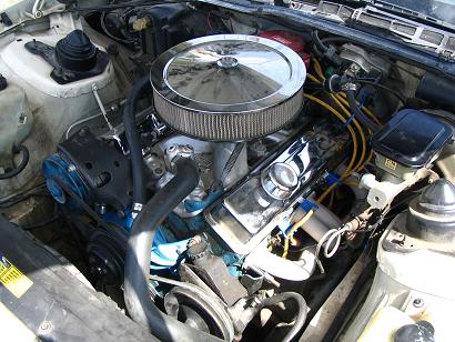

anyone have any pics of their header setup with a powersteering pump? I have the power steering setup off of a 79 van and the bracket mounts to the exhaust manifold

To hold the bracket for the PS pump, I used a threaded rod, threaded it into the exhaust bolt hole, and used a peice of steel tubing as a 'spacer' between the header flange and the bracket. Then a nut to tighten it all up. Worked like a charm.
Attached Thumbnails header/powersteering-headers.jpg
