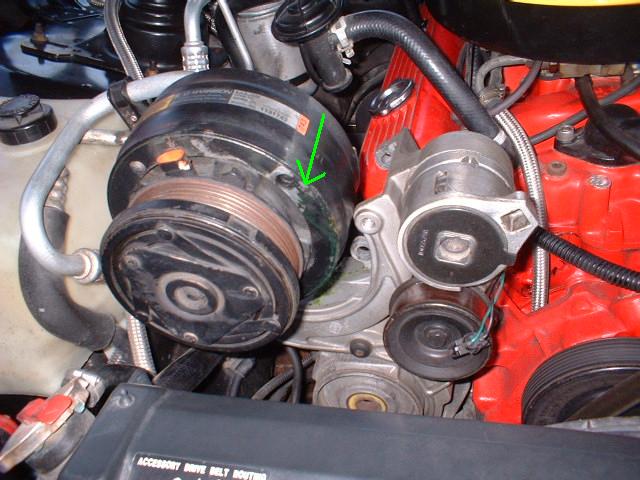

The plot thickens. I slid the compressor off it's mounting point and found this. Notice the green oil seeping it's way down and under. I like a good challenge!
Andy.

Okay, found this for sale, but the serial number is different. Mine is 1131743. This one is 1134343. It looks the same, but is it?
The gentleman selling it says it is off a Chevy truck, but doesn't know which one or which year!
Can anyone throw any light on this?
Andy.

Looks like a smaller pulley.

Pulley looks the same to me. I don' t know why it would work.
Hey.. if the pulley is smaller, that may just be a good thing.
