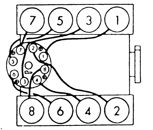

There should be a vacuum diagram on the under side of your hood. Study it for a while and then look at how your vacuum lines are located, then fix them heh.
This is how the firing order should go.

Make sure that the spark plug wires are routed exactly as you see them in the picture. Just for reference, #1 is on the driver side, and #2 is on the passenger side.
It is VERY easy to get the wire route wrong several times (done it myself enough times lol) Go through the firing order and your spark plug locations again and again, then get your wife/girlfriend, or neighbor, or mom, or anyone else to double check it... sometimes you'll find that you go through it so many times wrong, that you dont even see what you did wrong until fresh eyes see
Did you gap all of the spark plugs to .035 as well? If not, take them out and do that. A gapper is only like 2 dollars, and it's vital that they're gapped correctly.

Put the wires on the terminals exactly as it is in the picture I posted above. Though, if they put a new motor in, who knows whether they were able to get the #1 terminal lined up right lol.

ok so i got the car to start but it idles pretty rough, i rotated the dizzy all the way clockwise and when i use the timing light the notch is way to the left still... i saw the little metal bracket with the numbers on it and as far as i could tell the numbers go
*---------------12-8-4-0
the * is where the notch is on the tming pulley.. i think that maybe the #1 wire isnt on the right post on the dizzy cap... i am going to have to find it somehow, probably remove the valv cover and turn it manually till the intake valve opens and after it closes ill pop off the dizzy cap and see which post the rotor is pointing at...
any idea what post is #1 in reference to the electrical plug spot on the dizzy?
http://www.miamimarina.com/images/products/808483t3.jpg
thats what mine looks like, wth that squared portion..
could someone look at theirs and then open this one with paint and circle in red the post that i should be starting on? that would be the best!!!!!!
thanks guys!!!

I think I need to put the crack pipe down,lol. Sellmanb called it right. The pointer to the left of the 0 mark is retarded. Follow Sellmanb's diagram. Number 1 should be on a slight angle on the driver's side and towards the front of the vehicle. If you're concerned about it's placement, just trace that wire back up to the cap and then follow the firing order from there after you use a screwdriver to mark #1's location on the cap.
could you show me by circling the right post in taht pic? the only reference point i have is that square base part where the electrical connections plug in, or the screws...the whole thing rotates and i have rotated a lot so i know that the post isnt the same as yours.. i need reference to the actuall cap itself...
lolwow this sucks i think im gona have to do it the hard way with the valves or compression or something...
anyone have any good tips to find out exactly where the #1 post is supposed to be at?

You have to unplug your EST connector to set your timing. This will set the SES light, but dont worry, you can pull the negative terminal on the battery for a minute and whipe out the code.
The EST connector is the 3 prong connector at the base of the distributor. What it does is advances the timing. With it connected you wont get an accurate timing at idle.
When you look at the timing, and see that the timing is off so much, keep looking at the timing, but move the distributor counter clockwise (IIRC?) or whatever way to get it right on.
Dont worry about it being running at the time because the spark plug boots and such wont zap you (trust me, I was really scared about doing it my first time lol).
Even if you are one terminal off the entire way around, you can turn the distributor back and forth the whole 360* (basically) until you get it right.
Good luck and report back!

ok im not making any progress here guys...
tonight i went out there and did the compresison thing... crank ove rhte engine by hand wait til compression guage moves, take out compression guage, stick a tool in there to feel the piston, got it to TDC, remove the dizzy cap and saw the rotor pointing towards the battery, so i mark the dizzy and put it back on put the wires all back on made sure everything was nice and tight, rotate the dizzy to all the way clockwise and try to start up...nothing....adjust the dizzy, try to start...nothing... this goes on for about ten minutes until finally........ the throttle body explodes into a ball of fire... i jumped out and smothered it with a shirt and was like "the hell?!" then i rotated the dizzy again and noticed a clicking sound, then a couple more times and i saw that every time i rotated the dizzy a certain way, the injectors sprayed fuel.... so im like uhhhh.... so i figure thers a short somewhere or somthing so i undo all the plugs and twist the cap again, this time i get shocked, current ran through my arm down my chest out the other hand on the radiator- i jumped 5 feet and curse the car and thats the end of tonights camaro-session
any ideas why the injectors spray and i hear a clicking sound... i think i know why...
when i was looking earlier, the rotor doesnt rotate with the rest o the distrubutor assembly.. so the rotor was probably close to hitting a dizzy post and when i rotated it, my hand was touching that particular dizzy post and the current shot through me... i disconected the dizzy from the coil and when i rotated the dizzy, the coil shocked a nearby spark plug...
some weird stuff guys.. i dont know where to go from here, do i have a short on my hands? i just want this damn thing to run again!!!!!
the sad part is i think that i had the wires right in the first place but now i have no clue.

I hope that was a pun... funny either way.You had all the spark plugs on their posts all the way and still got shocked? That's not a good sign... it's never happened to me.
You dont have to take the rotor off to do this. By taking out the rotor it is possible that you put it back in backwards.
When fire spits out of the carb/tbi unit it typically means that your timing is way off... possibly even 180* out...
This is how I'd suggest setting your timing.
do what you are doing with the compression gauge, and checking for TDC and setting it to 0* base. Take out your distributor, put the rotor to the positon approximately where the #1 post should be (It shouldnt matter which direction the square end is facing as long as the post is approximately where it should be (at ~4:30 [like in a clock]) if facing from the balancer (see the picture above).
get a flashlight and a long flathead screwdriver and move the oil pump driveshaft (there's the top of the driveshaft if you look in the hole) and stab the distributor and mess with the driveshaft until you get it "good enough" hehe. If when you turn it over, it hiccups fire or whatever, turn the distributor around 180*. Then try it again.
Good luck, hope tommorow isnt as painful lol.

My bad.... stabbing the distributor is actually supposed to mean taking the distributor out of it's hole, aligning the oil pump driveshaft so the distributor will seat in the proper location and then put the distributor back into the motor (and when you do that you'll notice how it's LIKE stabbing something
Here's another way of doing the timing. I actually just read this today and like his way a heck of a lot more than mine.
https://www.thirdgen.org/techbb2/sho...hreadid=316262
Yeah, with all the plug wire boots off, it's no wonder it zapped you lol.
) .Here's another way of doing the timing. I actually just read this today and like his way a heck of a lot more than mine.

Let's try this again.
1. Move the crank until the indented line on the Balancer points
to the 0 mark on your timing tab. The indented line on the
balancer is considered the pointer.
2. Pop the cap off and see where the rotor is pointing.
3. Unbolt the Distributor and turn it until the rotor is pointing at
the 4:30 position when the Distributor is engaging the oil
pump shaft and ready to be bolted back down.
4. If you have a problem getting the rotor to point where you
want, use a screwdriver to adjust the oil pump shaft until
you can get the rotor to point at the 4:30 position.
5. Put your wires back on in the correct firing order, but make
sure number 1 plug wire is on the 4:30 tower.
6. Start the car and adjust your timing with brown wire, your
E.S.T. disconnected.
7. Using your timing light, set the timing to 0 and lock the
Distributor down.
8. Shut the car down and reconnect the tan wire for the E.S.T.
9. If the car backfired or wouldn't start, pull the cap back off
and unbolt the Distributor again and pull it up enough to flip
it so the rotor is pointing in the opposite direction.
10. Follow steps 4-8 and see what happens.
One way or another, this car is gonna start! Lol, even if it kills us all.

ok so i went home, i did some stuff along the lines of your thing but i am going to combine your instructions with another persons..
1. crank engine manually
2. wait/for compression by watching compression guage
3. once compression is acheived take out guage and replace with spark plug
4. take off dizzy cap and pull out distributor shaft
5. while holding dizzy, rotate rotor till it is at a 45* angle between 6 and 3 o clock..
6. use screwdriver to align receiving cylinder at bottom of the hole that the dizzy came out of so that it will accept the dizzy shaft. (is that little cylinder supposed to be wobbly?)
7. slide the shaft back in so that the it will mate back up
8. put dizzy cap back on and since the cap rotates 360 degrees, i dont think it matters what post the #1 plug goes on but for timing purposes, the plug should go on the post that the rotor is pointin towards...
now u are supposed to try starting with the EST disconected and get it fired up right?
i am starting the whole process over, i have the compression guage in the spark plug hole and im cranking the engine over manually....
am i on the right track?

Yes. Once you get the #1 piston to it's TDC, and at 0* wherever your rotor is pointing will be where your #1 terminal will be. Then put the spark plug wires in the proper firing order from there
Sounds like you're gunna get it this time
so the whole thing with making the rotor match the cap isnt necessary? just tell me it isnt PLEASE lolol
so if i really wanted to, i couldjust position the rotor so it is pointing directly towards me if i am facing the firewall so that i know that the #1 plug wire goes on the post that is directly "down" when im facing the dizzy from the front of the car..
am i right? the timing is just a minute change of how much sooner or later the rotor hits the post?
so for instance, the rotor rotates clockwise, and i rotate the distributor clockwise about a half inch, that just means that the rotor will hit it a half inch sooner when the cylinder is on its compression stroke?!!?! RIGHT?!
hahah i just felt that "click" in my brain :-D i think im gona be ok guys, i think ill be ok hah

Rotating the cap clockwise brings the terminal farther away, thus retarding it.
Counterclockwise brings it closer, advances it.
The rotor needs to be #1 on tdc of compression stroke.
-- Joe

The module only knows it's supposed to fire, it doesn't know which plug is supposed to fire. The relative positions of the rotor and cap determine which plug actually gets the juice at the time.
DAMNIT I HATE WHEN U TYPE UP A HUGE POST AND THEN HIT THE BACK BUTTON ON ACCIDENT!!!
ok long story short, camaro is running THANK YOU GUYS SO MUCH!
