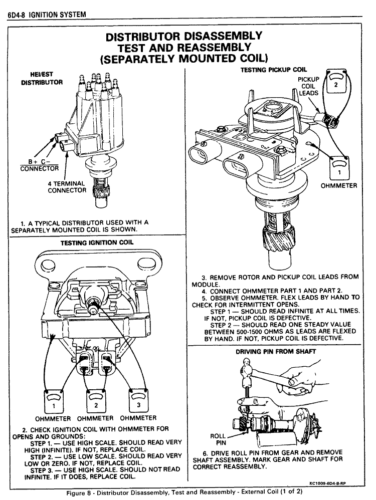

a bad dizzy can do a host of symptoms. Some being very very hard to diagnose... espescially when you want it to be anything BUT the dizzy lol....
If you want, you can get a junkard one for fairly cheap... but me, I'd get one from MSD, and I'd be able to justify it by pricing a new one from the dealer... calling the dealer to get brand new OEM replacement part quotes, and then looking at the much better aftermarket ones for about the same, and sometimes a little cheaper than OEM.. it makes me feel like I got a good deal... espescially if I can find that aftermarket part on eBay
Old Sep 1, 2005 | 12:59 AM
sellmanb's Avatar
Joined: Jul 2004
Posts: 1,840
From: Tigard, Oregon
Car: '86 Berlinetta
oh, and you should check other dizzy parts firstly by the picture below. I realize that it is for a V6 dizzy, but the same principles apply to a V8's, they just arent in the same place sometimes.

ok, well what dizzy should I get, I don't want to spend a terrible amount of money. If you guys could give me a part # or anything I have gotten alot of the wrong parts in the past, and on summit racing theres different types, magnetic, electronic, male, female hei, so what would work most diffinatly for my setup and application. Any suggestions....
Old Sep 7, 2005 | 09:57 PM
sellmanb's Avatar
Joined: Jul 2004
Posts: 1,840
Car: '86 Berlinetta
One from the junkyard should work well
