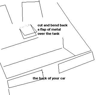

Do what everybody else does. Pull up the rear carpet a cut a access hatch door on the floor right over the gas tank.
Allows you to get in there are remove the tank pickup and re- work it. nice to add an extra pickup for NOS.
many times the fuel guage sender in the tank is about pouched, Good time to inspect it.
Just close the U shaped hatch you cut in the floor and seal it up with RTV and reistall the carpet.
No one but you will know the difference.
You can replace the in tank pump with a low pressure (7psi) replacement designed for a carb.
You can eliminate the in tank pump and rework the fuel pickup, then install either an electric 7psi inline pump over the rear axle on the drivers side and/or install a mechanical fuel pump on the engine.
A Carter 4594 electric pump make a nice replacement for a carb swap. No regulator is required.
The price is very reasonable.

now why would anyone want to cut a holw in thier floor? is it really that hard to drop the tank to do it right? and i would know it was there and thats bad enough. but if someone wants to do it like that its fine with me but i dont think i would ever do it that way.

Why make trouble for your self by buying a fuel pump that has way way too much pressure. get the right TBI pump to start with.
If your Third gen was a perfect car, it wouldn't need to be modified at all, would it.
GM should have built the car with a fuel tank service hatch in the rear floor over the tank to start with. Makes life so
much easier and much safer to service the fuel tank.
Countless cars and garages have been burned to the ground needlessly when peole have to drop the gas tank on their car to fix something. If you've got any rust under the car you're going to hate dropping the tank,
Cutting the hole in the floor makes things real easy now and later on. The hole is small enough that wil will not compromise the structure.
Someone else previously cut the hole in the floor on my car and I've had to go in and mess with the top of the tank a few times since I've owned the car.
One of the best mods on the car.

DON'T CUT A HOLE!
355gta,
Not EVERYBODY else thinks that cutting a hole is a good idea!
IMPO - This is an EXTREMELY dangerous and VERY FOOLISH move. The pick-up assembly is very large... in order to avoid clipping the lines one would have to cut an ENORMOUS hole in the rear of the vehicle. Unless one has decided that clipping the lines and splicing them together with rubber hose or some other method was not a FURTHER COMPROMISE in safety?
The previous owner of my son's '82 cut a HUGE hole in the rear of the car... He still couldn't get the pick-up assembly out!!! In the end he (the previous owner) ended up clipping all the lines and splicing them back together with rubber hose. The cut ends did not provide a flare or ferrule to properly accept a hose without potential for leakage. My son and I spent an entire weekend fixing that mess! We dropped the tank, replaced the entire pick-up assy, sealed, and welded in a new section from a J.Yard vehicle. I now feel that the vehicle is "SAFE" to drive (photo attached)
I hope you are able to accomplish your task with a regulator... If not... IMPO DO NOT CUT THAT HOLE.... Pull the tank.!
If you have an extra set of hands you can most likely do the job properly in an afternoon! We all want our cars to last forever......and don't like to think about a potential accident but do you really want to be rear-ended if your car has had this modification?
