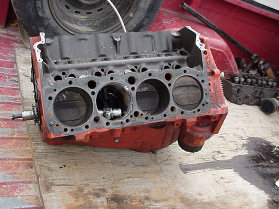

It only has about 1000kms on it (not even). The engine was a very strong puller, atleast till it vaporized a piston. I've heard rumors that Crane actually makes the cam, but you know what rumors are like.....

I'm not looking to build a full-on race engine. That cam was used in that busted block, with 882 heads (larger valves, though). It wasn't mine. Over 7000rpm for 30 miles literally killed it. He only had about 1000kms on it, lol. I got it for the steel crank, which luckily wasn't damaged.
