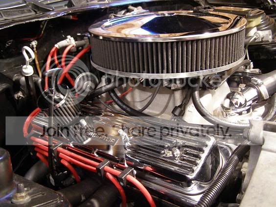

I just got a digital camera so I thought I'd attach a couple of photos:
