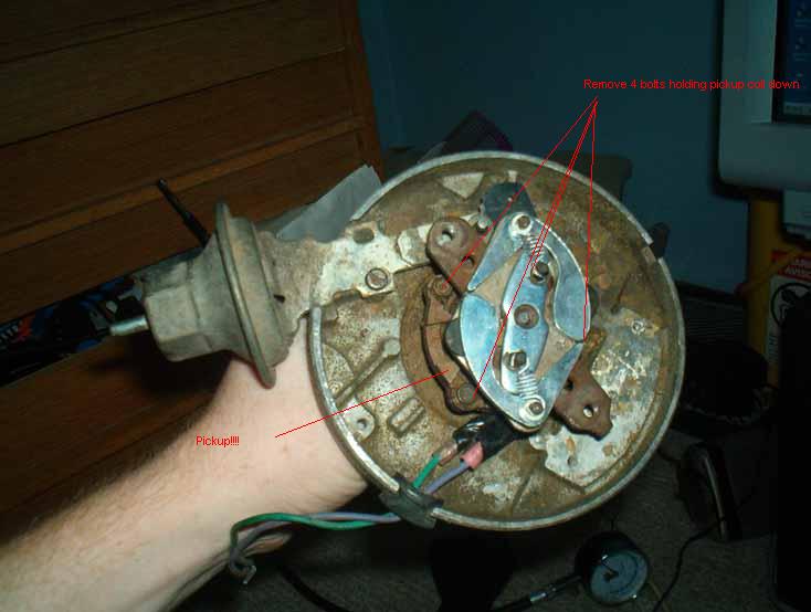

they are like $15 at any local parts store, replace it, and see if she runs...

Originally Posted by recaroguy
...........But, can you tell me how to get it out?...........and.........exactly where it is and what it looks like?
actually i got a photo for you.... you wont find one better suited for this anywhere...
wait 2 minutes...

'unfortunately to take the whole advance mechanism out, you have to remove the distributor, and remove the roll pin at the bottom, so you can remove the shaft....
heres that photo...
