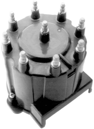

This is really frustrating, I changed the module in the distributor back to the ac delco unit. I took it to autozone & they tested it, it was OK. I put it in & still nothing. I pulled the plugs & changed them(gas soaked from so much trying to start). Still not running. Put spark tester on #1 plug showed spark.
I wonder if I messed up firing order when changing dist. cap. Niether cap has a #1 spot marked & things got a little cramped trying to change wires. I tried to go off of how the cap was molded (like first pole past hold down screw towards passengers side of car was #1. It sure would help rule that out if someone new correct location for #1 wire on cap. I have firing order diagram but if I started out wrong it won't help.

I hope this image will help. If someone can tell me the post that #1 goes on.
