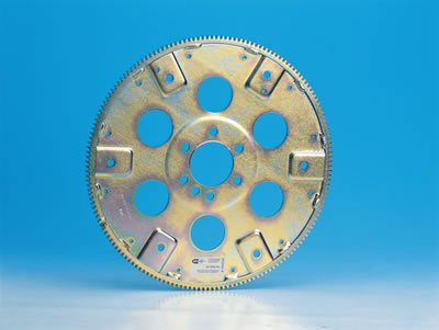

so which flexplate should i use. 153-tooth? neutral balance? internally balanced, 2 piece RMS.
kind of like this one from summit? SUMMIT RACING - FLEXPLATE - TCI-399573
