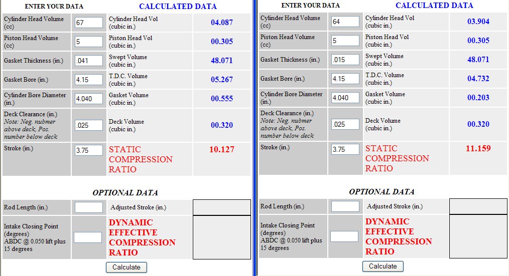

Well, keep in mind, the following info is based on your #'s. If you're confident that is your deck height, etc, then this info will be correct. If it's wrong, then garbage in -> garbage out right? ok:
Using this calc;
http://kb-silvolite.com/calc.php?action=comp
I'm seeing a 4.040 bore 350, with 3.75" stroke, .041" gasket, 5cc flat top pistons, 67cc heads. That shows a 10.1:1 CR.
Just going to a .015 gasket will bring your quench to a tight .040" (nice and tight, the way I like it ). That'll keep detonation away. That alone is worth .6, going up to 10.7:1. If you mill the heads down to 64cc (only 3cc's, that's not a lot), you can jump to 11:1. That'll improve your low end more than anything. The top end will be nicer though.
That's a big cam, so I don't think you'll need race gas for this.
Well, your call on carbide bits on the heads. I figured if they're $$race rite$$ heads, I wouldn't want anything that I could screw up on it. Personally i'd just use a few sanding drum rolls, and work the bowls, short turn, and contour the guide a tad. Don't touch the combustion chambers (or only a TINY bit), since you don't want to drop CR.

thanks sonix,
i'm thinking about going with the .015" gasket and maybe shaving the heads down for flatness.. because that is a small gasket.. i'll probably shave the heads down to 66cc and use the .015" gasket.. its gonna be at 10.9:1.. that should be good enough.. if i need to, i can always shave more.. thanks again for the help.. oh and how much power do you think its gonna be worth?? from 10.12:1 to 10.91:1? or to 11.16:1??

It'll still only be around 5% or so. But in your range, that's about 20 HP. I think since you were below the spec'd range for your cam, it'll probably help more across the RPM range, the 5% is just at the top end. Net overall change will probably be more. It'll effect driveability too (pure drag strip or street time as well?)
Heads, cam, intake and carb are pretty well matched. Pulling a 12.41 is alright, but I think that combo might be able to net you a bit better. Look for a weak link somewhere else as well.

At 0' altitude? hmm dicey. Use the intake closing angle and find out your dynamic compression ratio, that's the main factor. If that's low enough (due to a ginormous cam), then it might work. I'd make sure to polish the chambers like crazy(already done eh?), that'll drop the CC size a bit. 11:1 is pushing it, even with a cam that big. I'm thinking shoot for 8.5:1 DCR, that's about as high as you want to be on pump gas. Using octane booster is a waste of time, and annoying as heck.
I forget, were these AL or iron heads?

if you can find the cam card (on the website, or in your garage or wherever), it'll list the intake closing angle. It's a cam in the neighborhood of jbenges, (250*/260* ) so i'm thinking it'll bleed off the same amount of cylinder pressure. jbenge runs iron heads (right?) and 11:1. So i'm thinking with your AL heads you should be ok to do that.
AL heads, big cam, 11:1 should be ok.

this is what i got off the website.. the compression calculator you linked requires:
Intake Closing Point (degrees) ABDC @ 0.050 lift plus 15 degrees
the specs below only have the .015.. if i put in that number, it comes out to 7.795:1 dynamic.. so, not too sure what number to use.. and jbenge has aluminum heads.. but if you're not too sure about how high i can go, i'll just try it.. if i need to lower the comp ratio, there are bigger head gaskets..
Valve Timing At 0.015
Open Close
Intake 47 79
Exhaust 87 39
These Specs Are For The Cam Installed At 106 Intake CL
Intake Exhaust
Duration At 0.05 260 260
Lobe Lift 0.37 0.37
Lobe Separation 110
