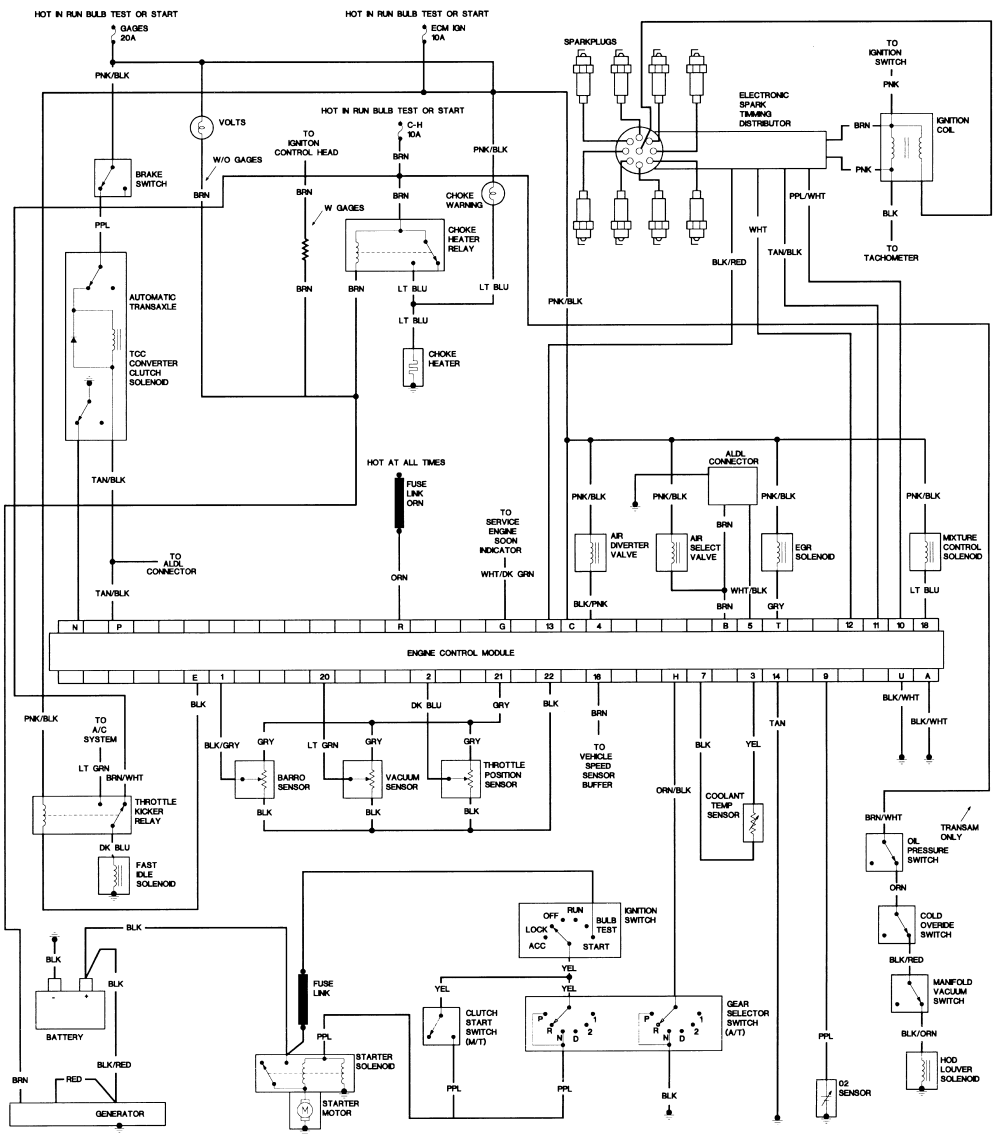

My car has had a problem that has been bugging me since I got it last May and I think I finally fixed it. I followed this troubleshooting diagram from the shop manual and narrowed the problem down to a bad ground connection to the coolant temperature sensor. So somewhere between the ECM and the Coolant temperature sensor, there is a break in the ground cable. I put some alligator clips between the ground lead of the CTS connector and the alternator bracket and now I don't get the Check Engine light. Now all I need to do is make the fix permanent.

I checked the wiring diagram and the CTS ground (black wire) goes straight to ECM pin 7 and the yellow wire goes straight to pin 3. It doesnt show anything else connected to the ground wire (Unless the diagram is not correct, but it should be) So would it be OK to run it with the alligator clips connected to chassis ground for a few days until the weekend when I have time to fix it?

The other day I found out there was a problem with the ground cable going to Coolant temperature sensor, so I put a wire from the CTS ground to chassis ground temporarily.
Today, after having replaced about 1 foot of the CTS wires and soldered all the connections, and having retested the resistance between the ECM connector pins and the CTS ground pin a bunch of times (always 0 ohms), I decided to open up the ECM. I was originally just going to clean the contacts for the connectors, but after close inspection, I found that the trace going to the CTS ground pin was burnt near the edge connector. I soldered a strand of wire to repair the burnt trace and put everything back together.
Turned on the engine, tested the voltage at the CTS connector, and couldn't believe my eyes
when I saw 5.00V in the multimeter
So I'm sure I can now say: PROBLEM SOLVED!
