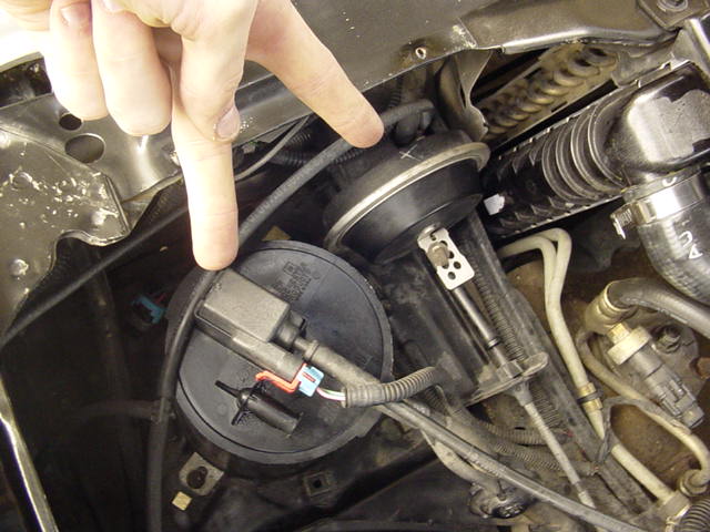

what is...
the objects im pointing to in the picture attached?
Old Feb 8, 2007 | 03:06 PM
Posts: 27,899
Likes: 2,437
The cylindrical object is the charcaol canister; it traps fuel vapors from the fuel tank.
The one that has what looks like a throttle cable is the cruise control diaphragm. The regulator feeds it vacuum to actuate it, which pulls the throttle open.
