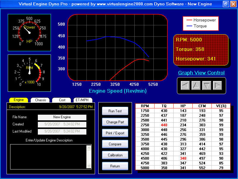

Originally Posted by nbays1975
How much HP/Torque should this produce.
Since your already starting out with a 383, thats a nice boost to your torque curve. Here is the computer dyno run...

Thanks for the dyno. I was hoping the HP would be a little higher, but the torque looks great.
that is a pretty big cam... especially for a Stock FI setup
The full injection is not exactly stock. The injectors are much larger (30 lb/hr) and the intake plenum is an SLP. Also, I believe the fuel rails are different. I'm assuming/hoping that the fi was setup to match the cam. However, it does seem to run rich. I'm guessing thats due to the cam.
