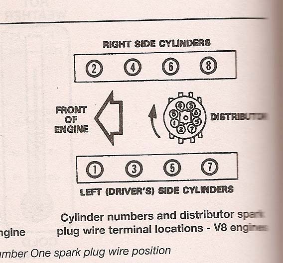

My son's friend removed all the plug wires and did not mark anything.
Can someone explain IN DETAIL how to put the wires on?
Which cylinder is #1 - how to find #1 on the distributer - etc.
Please do not reply with "Do a search" - we need actual help.
Thanks

Hope this helps!

Re: Plug wires install 91 v8 - Please help
A picture really IS worth 1000 words!
Many thanks Jason
