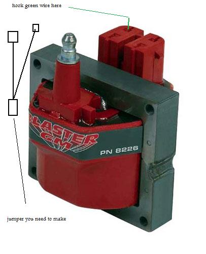

its set to RPM's, i tried chassy ground and neg battery term doesnt read at all, what do u mean hook green wire to jumper? i have an external 4 wire + spark wire coil, plus i lost my manual ahhhhh!!!!!!!!!!!!!! wish i had it..Originally Posted by cooter26

second coil, i hooked the aligator clip wire there, and the booted wire to neg term and got nothing... need to make jumpers were im totally confused..
the second coil is my coil, i hook the green wire where u stated because that is the tach wire, so were do i make jumper?
this is my last post on this one. the green wire goes where i showed and the black goes to a good vehicle ground. best being the negative terminal of the battery. the jumper is only so you can have the original tach wire and your tach wire both hooked up. if you have it hooked up this way, start the car and get no reading the 5 year old tester is broke, i know mine is shot and gave me a lot of false readings. Good Luck
