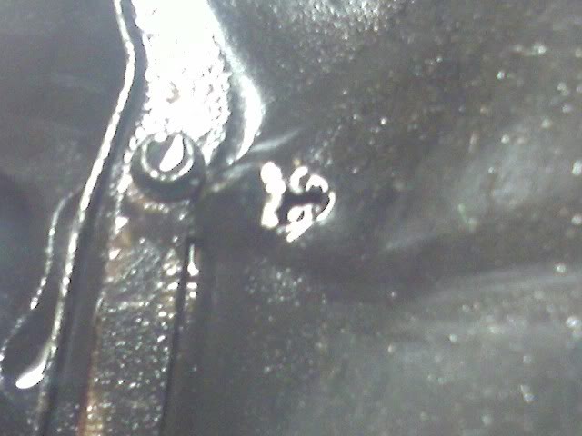

oh yeah, while under the car finishing up the prep work i found a nice sized hole in the side of my oil pan next to the filter/oil cooler. pictures coming soon.

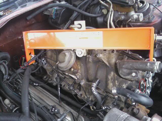

hey guys, before the rain started i test fitted the load lifter and chains. in the picture below i have a grade 8 bolt on the front of the driver's side head with a grade 8 washer and at the rear of the passenger's side head i have another grade 8 bolt with a grade 8 washer in the last intake manifold hole. i'm thinking of adding one more lift point on the back of the driver's side head to support the combined weight. what do you guys think?

p.s. where do i get one of those plugs? the one's i have a work for the fwd transmissions don't fit.

If you're going to just lift it, get it out and get it down you should be fine. Just dont leave the whole assy. hanging for a long time and definately dont get under it at any time.
Those plugs are available from Summit or Jegs, or probably any local speed shop.

hey guys, finally pulled the motor and trans out on sunday. worst part was trying to move the hoist to pull the motor. so i used a special tool as you'll see in the picture below
lol this was after i pulled it away from the car. just want you all to know i had both ends of the tow strap attached to the hoist to pull it evenly.
wow, i didn't know that motor was so under spec. forget that engine, then. do any of you guys know of a good long block that will work good with TPI?

and now, what you've all been waiting for...the photos!

Wow..
Thanks for that final photo..

all I can say is Holy S*** man!!!
