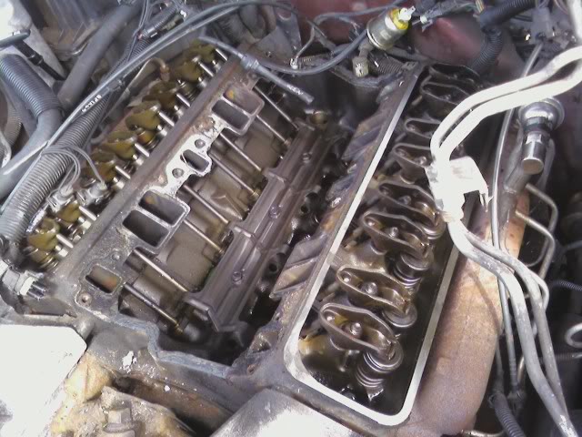

i took the driver's side valve cover off today and didn't see anything obviously wrong. i think the lifters are collapsed because the push rods all spin when i had them between my two fingers. i tried to crank it over but it seems it drained my new battery already. the knocking noise it made when it did run sounded like a loose wrist pin but it didn't have any knocking or unusual noises when i parked it. what do you guys suggest?

ok fellas, i had some extra time to revisit my GTA on this problem. i tried to start it and it wouldn't turn over. i charged the battery and hooked up my remote starter button. pushed the button and starter made one loud click. looking at the engine the crank moved about half an inch and then went back. i didn't even have a chance to hook up the oil pressure gauge. what do you guys think?
The valvetrain.

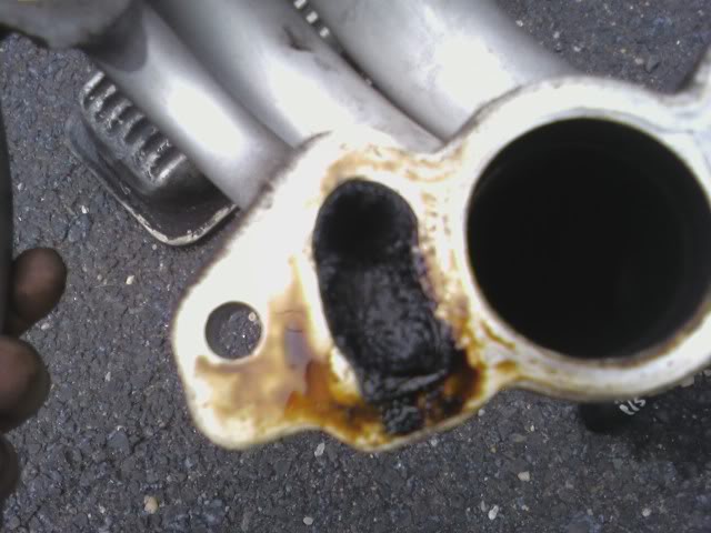

Clogged up EGR port in the runner =\
close up of galley.
this weekend...the heads come off.

Re: is my engine done?
Other than that EGR passage, I'd say that looks pretty darn clean!
i know! i was amazed to see it without sludge or anything up there. i'm really starting to get curious about how this thing grenaded on me.
also, has anyone else used that website gcgarner recommended? not a lack of trust but i just want to know is it safe and if the product is really that reliable. seems kinda too good to be true with a 7 year warranty and all.

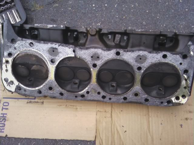

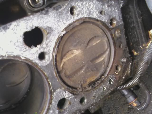

*update*
i got around to taking the driver's side head off and i think i found my problem. after taking the head off i turned the motor over by hand. all of the pistons were moving except for #7. yeah...that's bad. looks like i'm buying a 350!
Old Aug 10, 2008 | 04:35 PM
It's hard to believe it did that idling in the garage.
Are you sure you didn't loan it to your brother-in-law right before it was parked?
Old Aug 10, 2008 | 04:43 PM
i know it's the weirdest thing! she wasn't making any knocking sounds at all when i stopped driving her. lol thankfully i'm not married or else it might've been worse. with this as culprit i bet there's some real good silver in my oil pan.
Old Aug 10, 2008 | 04:51 PM
  #43
Supervisor42's Avatar
Joined: Jul 2005
Posts: 1,675
From: Arab, Alabama
Car: 1988 Trans Am GTA
Engine: 350 4BBL
Originally Posted by GTAman
... i bet there's some real good silver in my oil pan.
Yea, with extra chunks. I wouldn't even take the pan off. Somewhere there is a recycling yard with a dozen just like it...
Spend some quality time instead, planning the 350.
