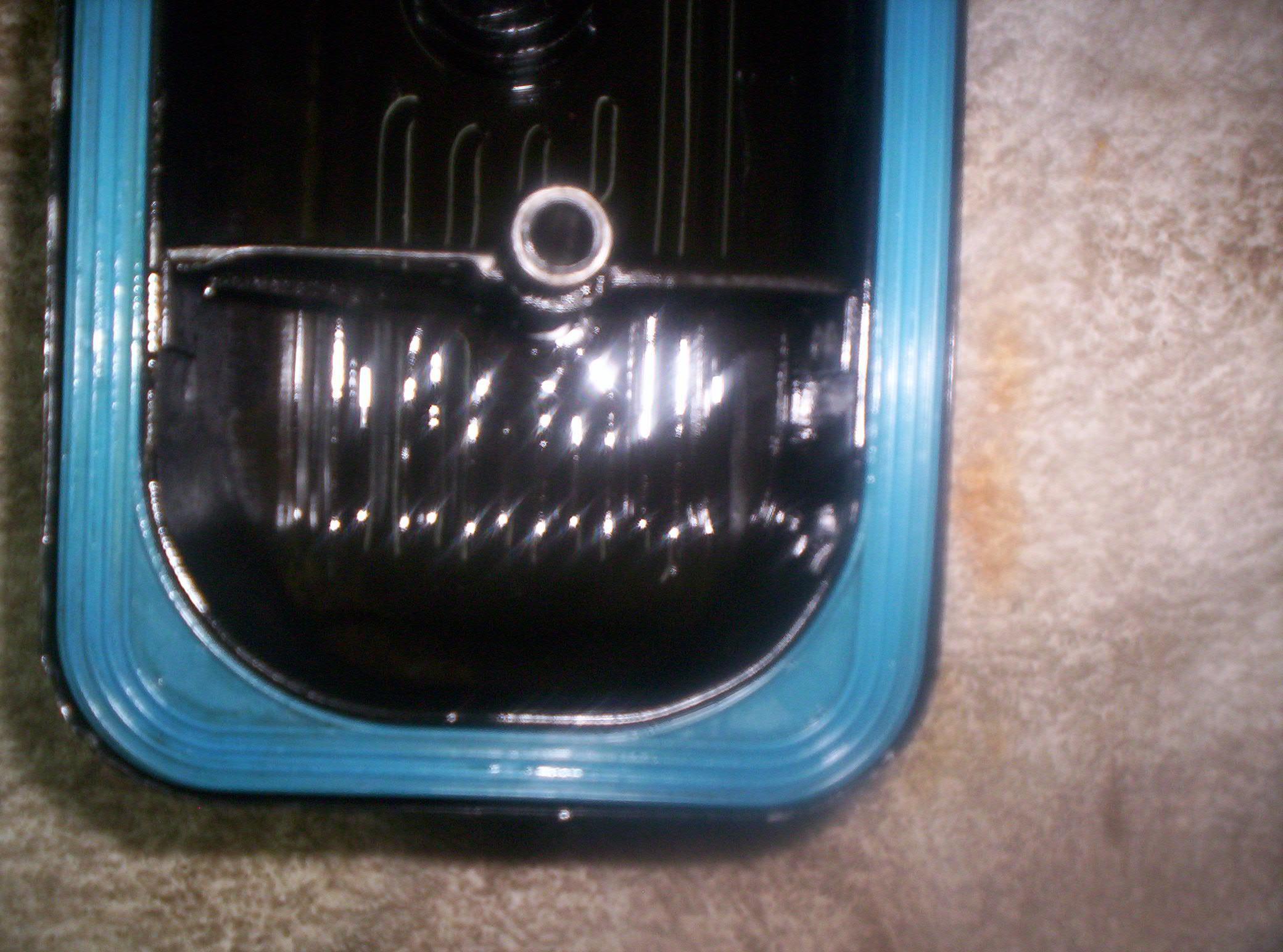

I had to clearence the stock valve covers to fit Comp Pro Magnum 1.6 rockers. It's the width, not so much the ratio.

were you even able to bolt them down? I'm able to, I was more concerned about the height than the width. IIRC, the rockers I have are the "narrow" body ones.
Hey hey! I remember'd which ones they were!
http://store.summitracing.com/partde...6&autoview=sku
Ya, they are narrow body. It doesn't say on there that I would need to use different valve covers though.
