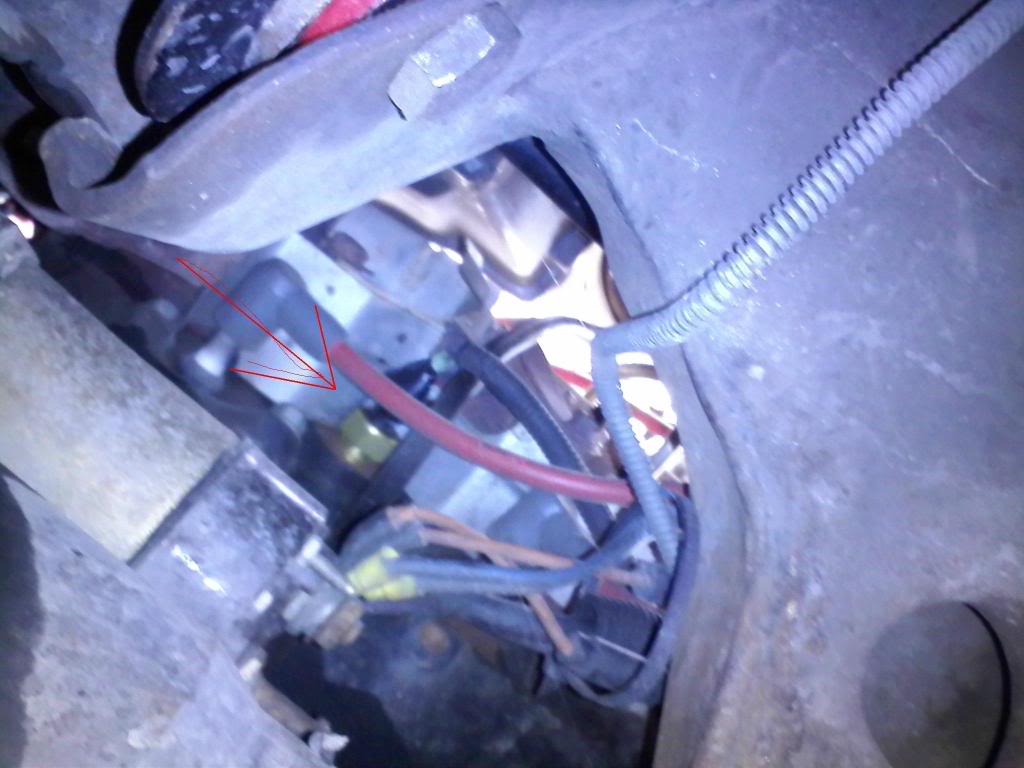

Re: Sensor Identification
is this what ur looking for marcus?
