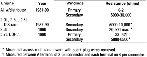

I cranked the motor and there was spark!, but god was it lame. Weak and yellow, not what I wanted to see. Does anyone know what the specs should be on the coil or any other parts of the dizzy I could check with a mutlimeter?
