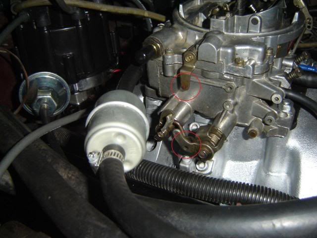

the canister on my old motor, was between the valve cover and the carb, not behind it. It needs to be out more, hmmm let me see if i have a pic
here, check this thread, post #5, not mine, but i clearly shows the canister and how it needs to be orientated
link didnt work, disregaurd the red circles
here

86TA : I checked and all the pics I have are over the 1mb limit. do you want me to send the picture at an email address ??
You are right. The canister is between the valve cover and the carb (must of explained myself wrong).
If you look at the picture (post #5), in my case the canister will rotate all the way and hit the intake manifold in direct relation to the bottom corner of the carb on the passenger side.
What do you mean pop up the dizzy and rotate around the carb ??
sorry, i was pretty tired when i posted that and it was a brain fart, disregaurd that i had the rotations for advance/retart backwards.
I still say you have something messed up with the dizzy. With the canister hitting the carb, where is the #1 post facing? probably more towards cylinder 5 or 7?
