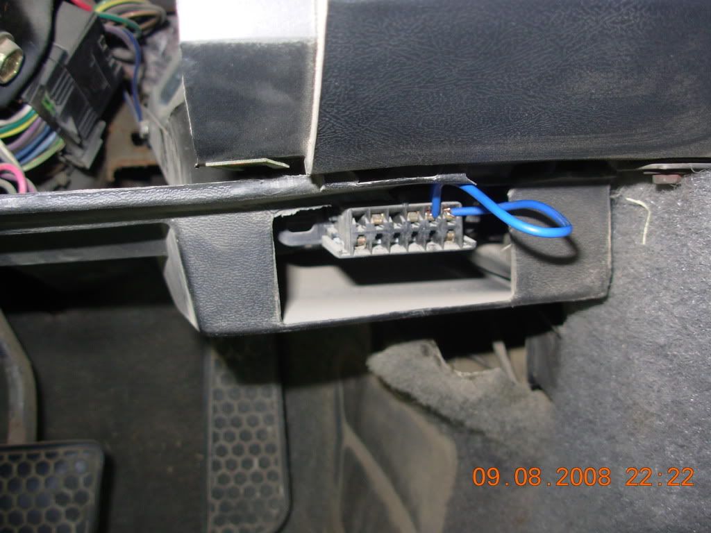

Ok. So the guy using a paperclip was trying to ground the a&b terminals in the ADL Port. there is achance that he did not cross the right port and shorted out a fuse. First check all fuses.

Sounds like your battery is completely dead, that would also explain your clicking. I doubt it's your starter.
Oh and for his paper clip method, that's the easiest way to do it, and no he didn't fry anything.
