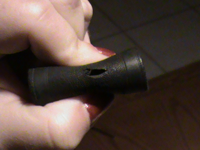

Good news. My wife was running some part tests on the car and had the fuel pressure gauge on the whole time. All of the sudden she yelled "got it!!!" and ran to the back of the car and started heading to the fuel pump. The pressure had dropped to 2 psi. So she figured she knew it was the pump. After taking the pump out....she found a nice size slice in the little rubber pump to sending unit hose. Popped on a new piece of hose and bam......car runs great again. Fuel pressure is at 8.86 psi but it runs excellant. Thanks for your time thunder and gurk. Im so happy I have my toy back. Now I have to make progress on it so I can smoke my wifes GTA lol. I hope gurks problems fixed. I'll be checking back to see. Yall take it easy and thanks again.

Yea that would do it lol. Its ok just because the guage reads 8.86 dosnt mean its actually 8.86 psi as there not perfectly accurate anyways. Although congrats on the car anyways a nice cheap fix as well.
