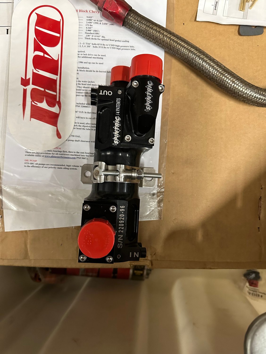

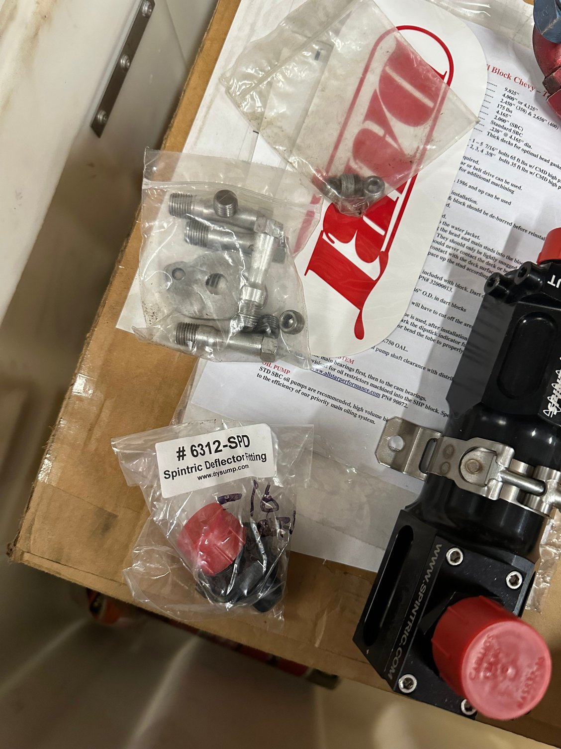

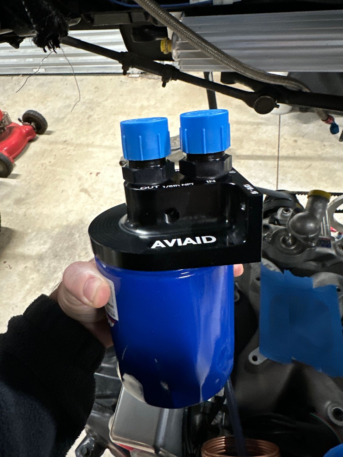

This is a general list of stuff you’ll need if you do this.
cooler sizes would change based on power output. Tank sizes will vary based upon where you can put the reservoir. Also sanctioning bodies dictate catch can requirements etc etc.
Fitting angles are totally dependent on where all of your components end up and also bulkhead fittings may need to be purchased.
You’ll need to also install a block off plate on your #5 cap or plug the oil port.
Hose type and tubing is totally up to you but if you use flex hose you should insert the stainless support coil into the suction lines so they don’t collapse.
Also consider installing piston oil squirter jets because the higher vacuum in the crank case and lack of oil in the pan can cause oil to not be delivered to the wrist pins sufficiently.
If you plan to make a change to your motor design plan it from the beginning.
Or install an EDM connecting rod that feeds oil up to the wrist pin.
The benefits in performance and reliability are truly unmatched.
