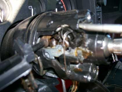

thanks for the reply, I took photos of what I was talking about.
I still have everything apart thank GOD. this is where the back of the key part of the ignition goes to. here is a closer up view of it
Now this is the part that I think in responsible for making grab the prongs of the key/ingition switch and really turn on it before it will turn over and start. but once it does, it starts right up.
here is where the rod (??) that connects to the ignition switch at the bottom of the steering shaft(?)

it sounds like the ignition switch at the bottom of the colum needs to be adjusted or replaced, but we have a pick up that the little gear in the colum broke and it would start and not shut off so it could be the gear tooths are worn or broken and you don't have enough turn in the key to push the rod far enough on the ignition switch to hit the start position

thanks, I looked at my ignition switch on top of the column it was bad, so I replaced it, although I do not think that I pushed it all to the back, nor did I put the keys in the acc posisition. Is there pictures in here that will show me how to do that? Also with the help parts. I am afraid that if I take those parts out, I will not remember how do it again
