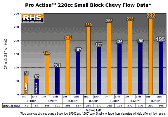

As I'm working on another build (400 bored .060 over), I'm considering different heads. Recently, RHS heads have peaked my interest. The flow numbers on the 220cc head seem pretty decent considering the price point.
So comes the question. Since RHS offers the same casting in Iron and Aluminum, with the same chamber design and size, and the same flow numbers do we go with Aluminum or Iron.

At $918 per pair, and decent flow numbers (265/186 at .500 lift) they seem
like a decent deal and outflow trickflow 195s. (252/183 at .500 lift)

When modeling in software, the difference seems to impact Torque by about 6 foot lbs..
