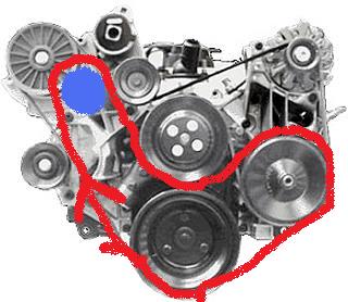

TBI car now carbed. I'm deleting A/C - already deleted AIR. And I hate the stock brackets and the idea of the A/C delete pulley - I want a simple oldschool look. I'd like to move alternator to pass side, BUT keep serpentine belts.
1) Can I use brackets such as these to mount an alternator on pass side and remount P/S pump (to get rid of that bulky bracket)?
Alternator: http://cgi.ebay.com/ebaymotors/BILLE...Q5fAccessories
P/S Pump: http://cgi.ebay.com/ebaymotors/ALUMI...Q5fAccessories
2)Will this belt routing work? (the blue dot is the new/moved alternator, and I'm assuming I'll have to change from a reverse to a standard water pump)

you may still need a tensioner. you also don't have much of the belt touching the crank pulley...you may have a slippage problem

The alternator bracket does the tensionng with the adjustable turnbuckle that comes with it.
