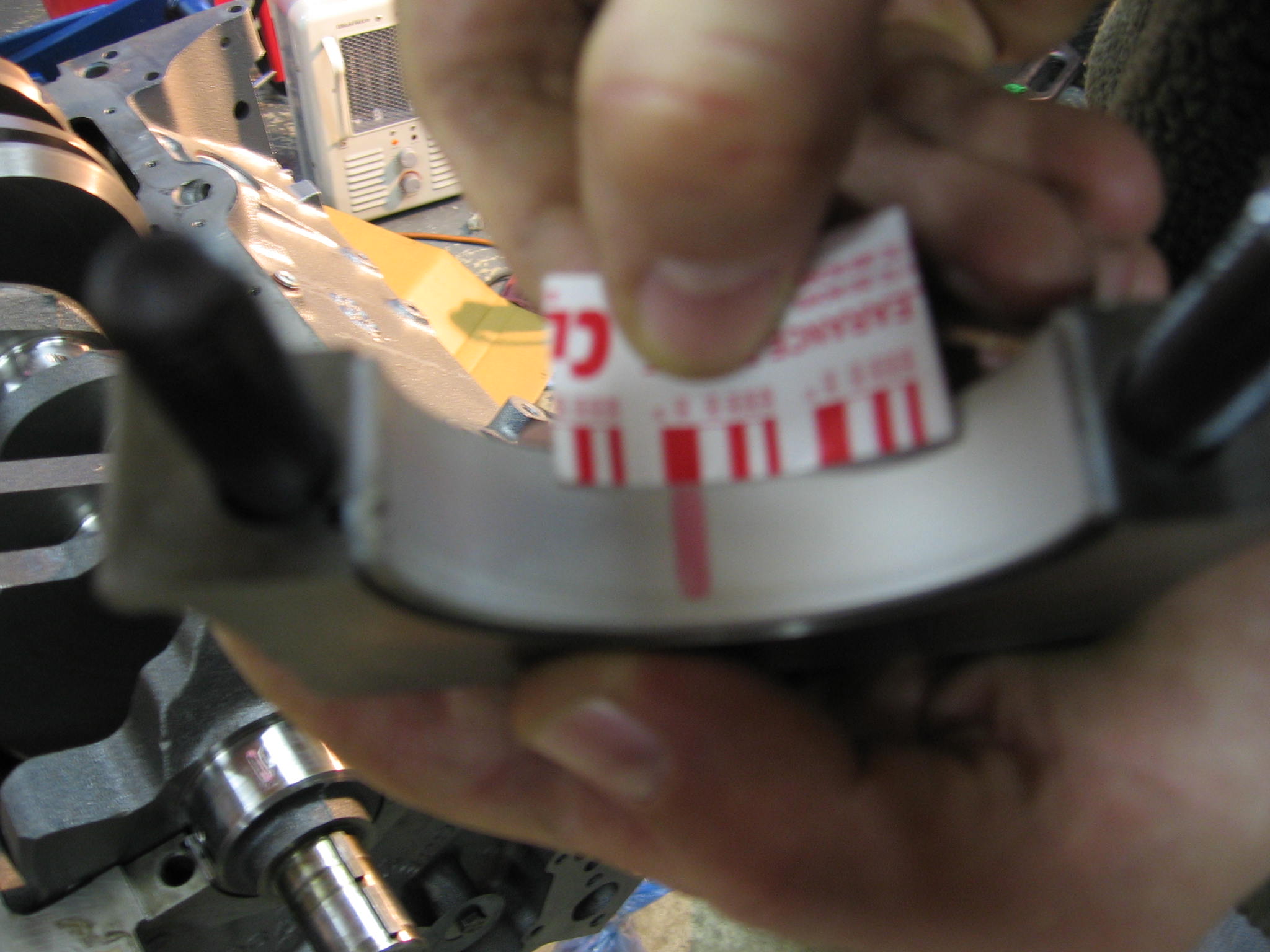

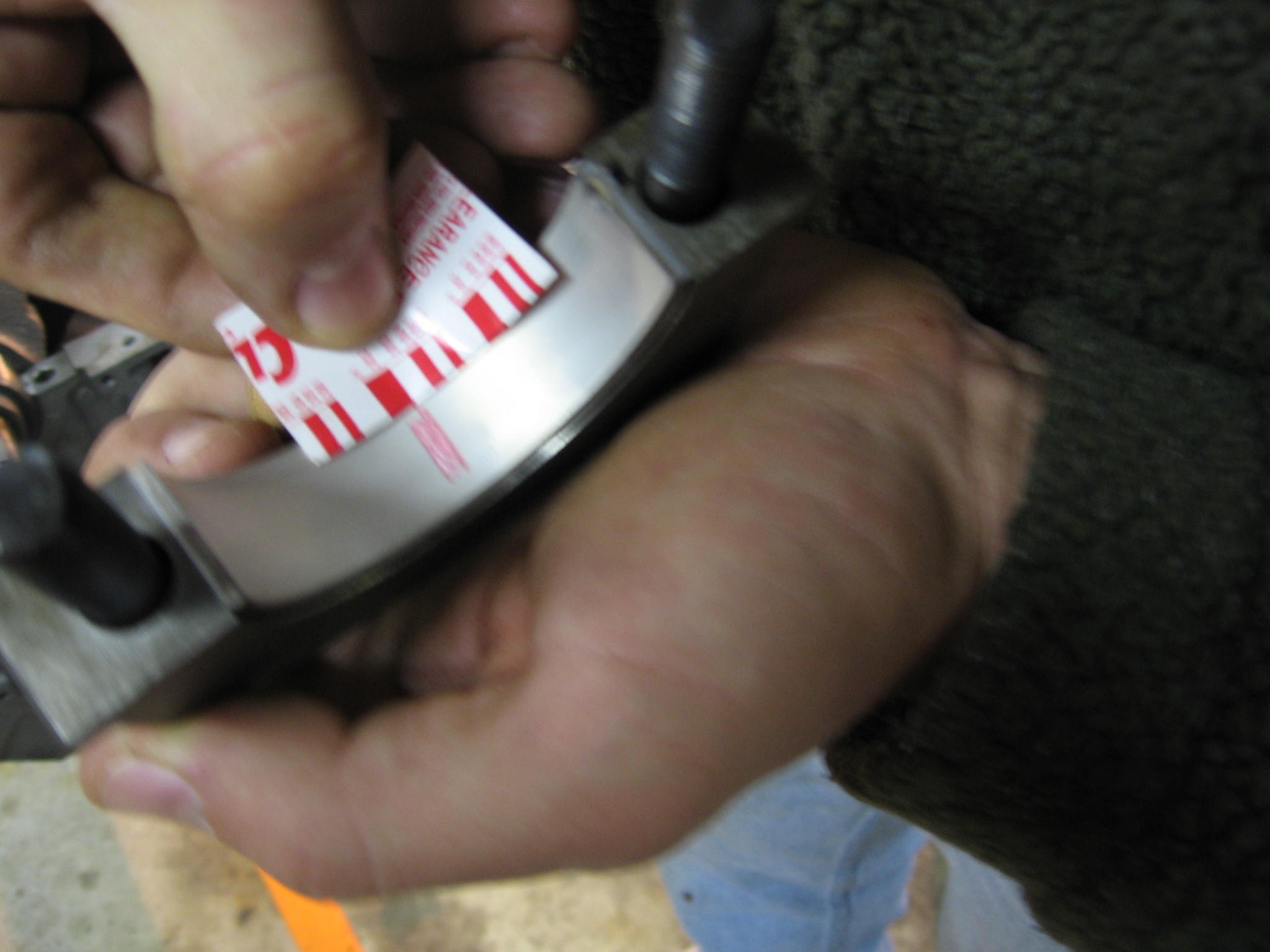

Well, thanks to all for the thumbs up on the plastigage. Here is what I show using standard size clevite main bearings, on a polished 40k crank, torqued to 75 lb/ft. They are all within the red .002 block. So whatcha think? Thanks again

I am using std hastings brand cast iron rings, though getting the oil ring to go into the bore is giving me he11. So the .002 on the plastigage is good?

Yes, .002" is GOOD TO GO!

well for what it's worth I did "gage" the mains and the rods, and got .002-.003 for everything. The crank is in and spun freely, and with the pistons/rings installed it takes less than 30lb/ft to rotate the whole rig. Well under the 35-40lb/ft spec. Thanks to all.
