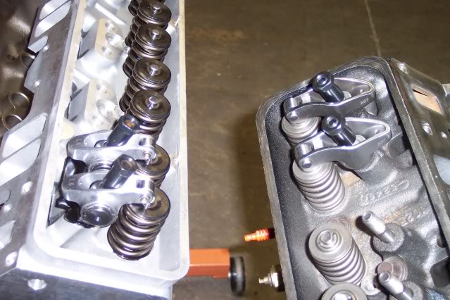

Dont do any bowl work to the 062 heads, the first time I pulled apart a set I couldnt believe what a good job GM did casting these heads. If your going to run an aftermarket cam remember the max valve lift on vortec heads is .470" . You can have the guides cut down or do the ghetto retainer grind (search it) for more lift. I would say 230s duration on the exhaust side and 220s on the intake would be the max and maybe even a bit much. If your running a carb (non ecu) you can go with a closer lobe seperation to get the idle you want, something like a 110-112. Heres a clip of my car with a 224/230 ...and a 112lsa cam in it It also has alot more done than that but the tighter lsa has alot to do with the loping
<embed width="600" height="361" type="application/x-shockwave-flash" allowFullscreen="true" allowNetworking="all" wmode="transparent" src="http://static.photobucket.com/player...A/PA200636.flv">

With the setup you have, stock cam + 1.6RR should put you in the low to mid 13s. Vortec heads use self aligning rockers.
I've ran 2 350 Vortecs with the 1.6 roller tip rocker and didn't have any coil bind or rubbing & they fit under my stocker valve covers. On my Suburban I ran them for over 70K miles before I replaced the motor with a built 383. Those rockers didn't show any abnormal wear nor did the pushrods even at 220K miles.
Left are 1.6 SS full roller rockers that will not fit under stock valve covers.
Right are 1.6 roller tip rockers that will fit under stock valve covers.

Posts: 9,917
Likes: 884
From: 53.0907° N, 113.4695° W
Re: Vortec questions
True.
I had to clearence the internal rocker cover brace to allow for the additional width of the Comp Pro Marnum full roller rockers.
Originally Posted by skinny z
True.
