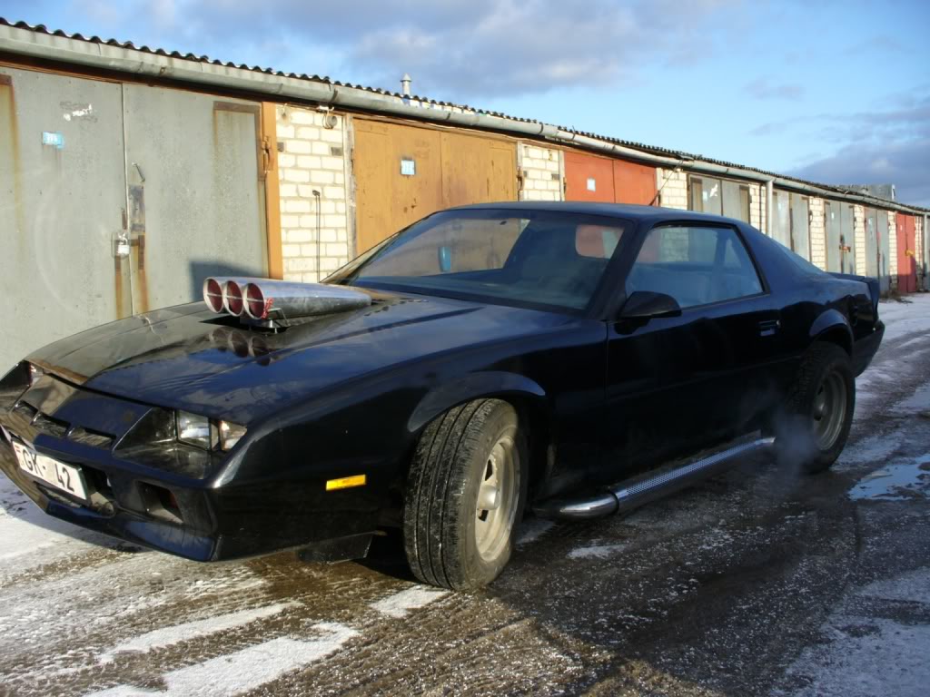

How to secure rocker nuts. I tried to use red thread lock, but after 1K miles some nuts became lose.
here is my project camaro almost done.
