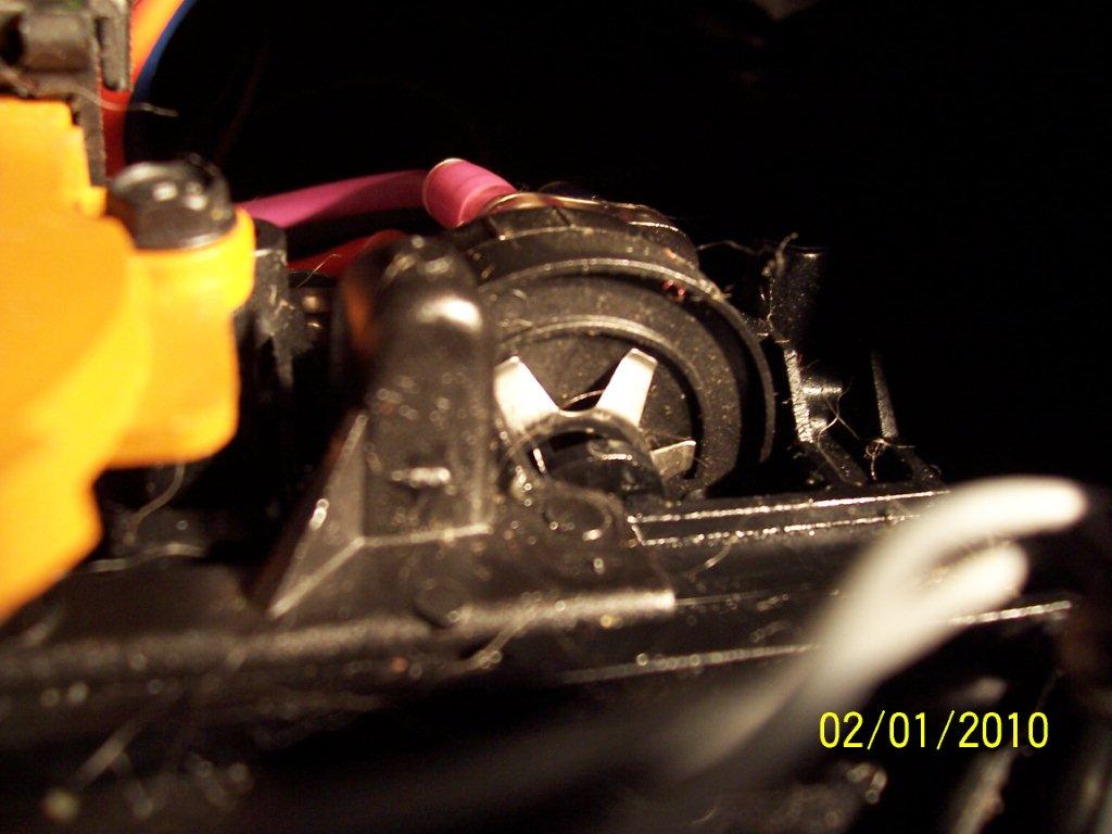

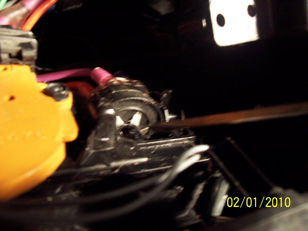

So i found the leak Its on the switch looks like this peace can be snapped back on not sure. It shaped like a clip on the other side for what i can see cant get it to clip. inside If i hold it in place my vents flip and the hiss is gone. Heres some pics best my camera can do anyone know can this be fixed or get a new switch.

That's it you have it. Now you just have to figure where the clip that holds it in place is and put it back togeather. May have to get another piece from a junk yard.

I can't exactly tell from the pics but if you cant fix yours you can buy the whole assembly on ebay for less than $10 any day of the week. You can probably find one at a junk yard too but given that it is early Feb. and you live in Chicago, I'd check ebay.

Well napa had it for $36.00 GM discontinued it If any one can find it cheaper GM part #16032395
