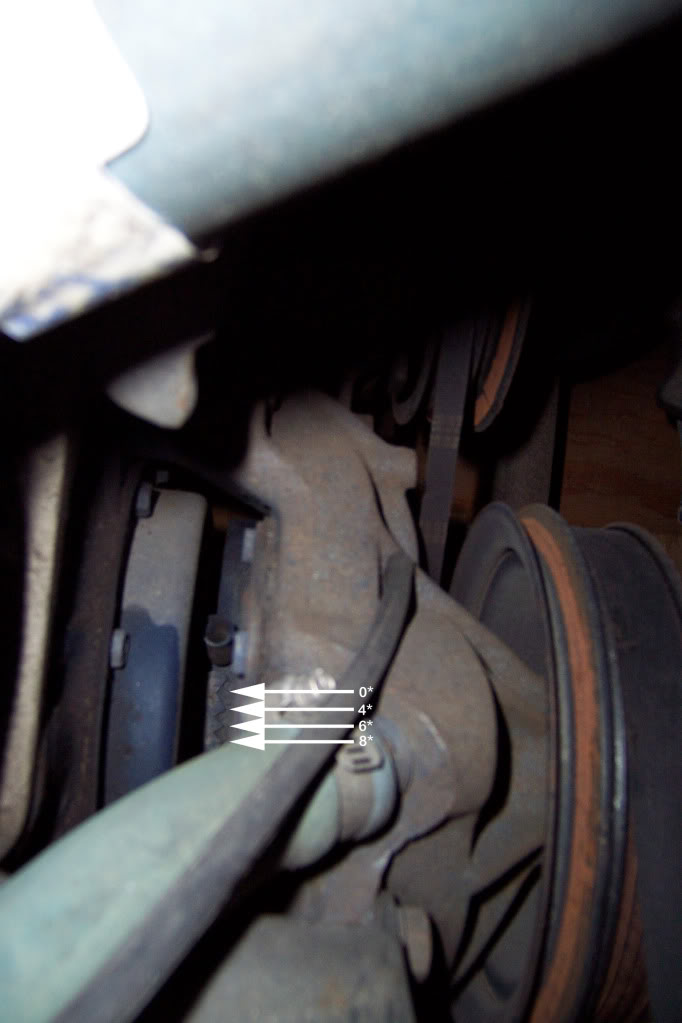

Sorry to bring this one back to life, but I'm another noob when it comes to this. I was just hoping someone could clarify this for me. Thanks for the pic KNBlazer, that's exactly what my timing tab looks like. Reading this from the article on the site:
If you still can't read what's on your timing mark: Assuming you are standing in front of your car, facing the engine, the "valley" of the biggest of the v-shaped notches should be zero degrees.
The Vs are upside down when you look at them from the front of the car.
The next peak (pointing towards you) to the left of the big V is 4* advanced, one more peak to the left is 6* and so on in 2* increments.
Accordingly, the one and only peak to the right of the big V is 2* retarded.
If I understand that correctly, that corresponds to this, right?
So the large VALLEY is 0*, yes?
Thanks in advance!
