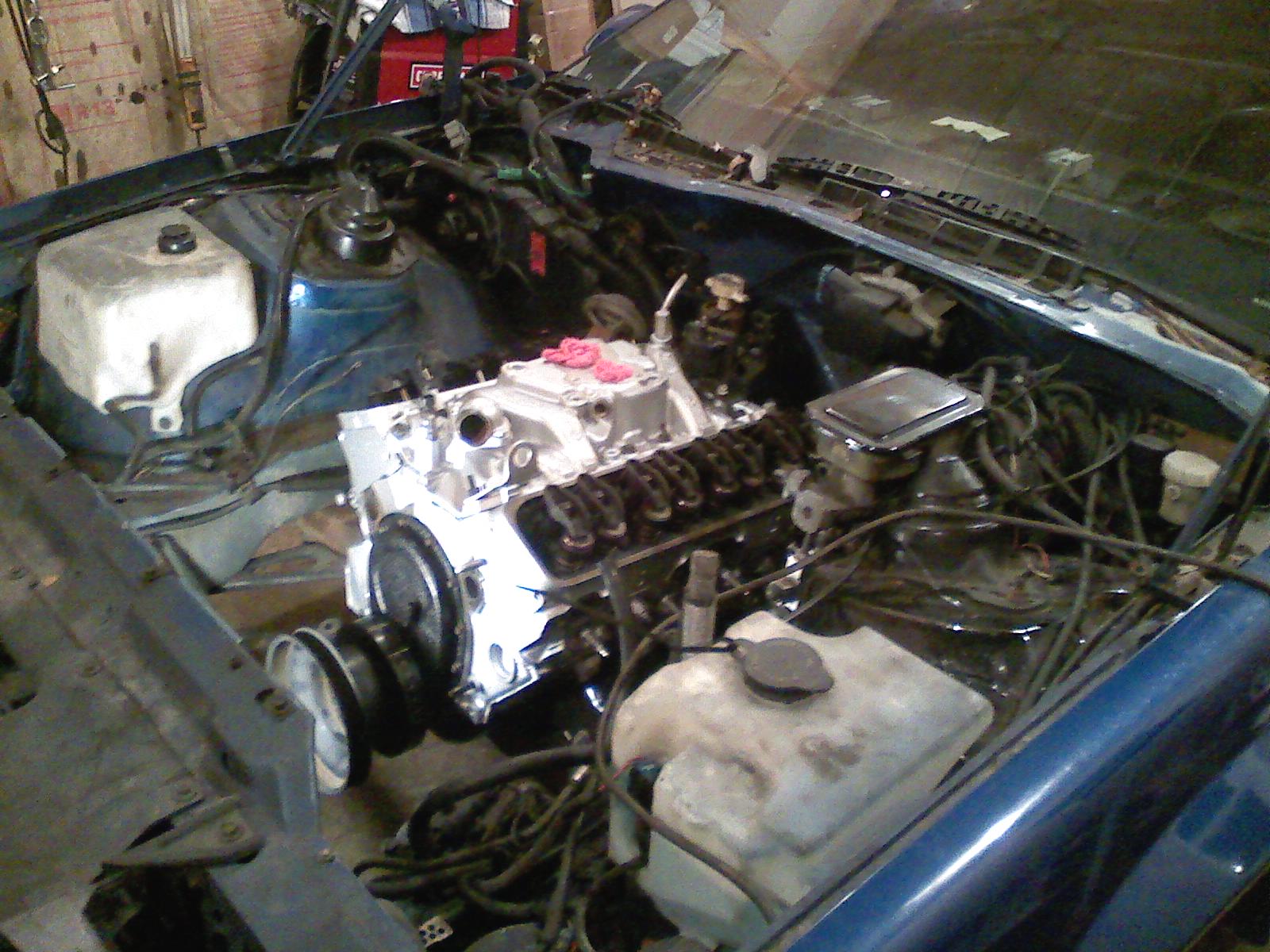

Re: Getting ready to put the engine back in
Well, I got the engine back in last night!! I left the engine mounts loose to make it easier to drop back in. I'm a little concerned about if I have them tight enough, so I will go over them the next time I get back in the garage. I have the control arms off so I could get a wrench on the nuts, but its hard to tell if I have them on there good enough when I can barely get my hand and a 15mm wrench in there. Any suggestions on tightening the motor mounts up?
