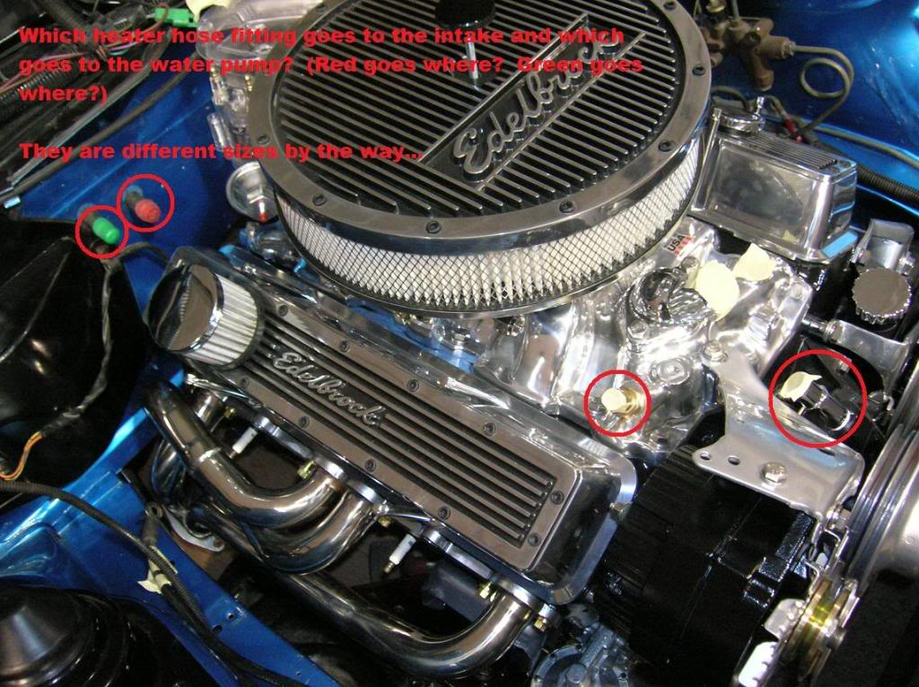

[[Quick Question: Heater Hoses]]

Large goes to the water pump, small to the intake manifold.

Re: [[Quick Question: Heater Hoses]]
Blinded again
There is no check-valve in the system or core, so either way will work.
The intake is the high-pressure side. The pump is the low-pressure side.
Some 3rd-gen radiators will have the heater return (low-side) going to a port near the top-side of the radiator. I prefer the radiator return route so that the coolant has to go through the radiator and cool before being forced back into the block.
I use a ball-valve on the high-pressure side hose so I can cut the coolant flow through the core during the summer.

Can you take a picture or something of your setup, sounds kinda different?

Interesting, so you can just shut off one side of the heater core and not affect circulation for the rest of the cooling system?
