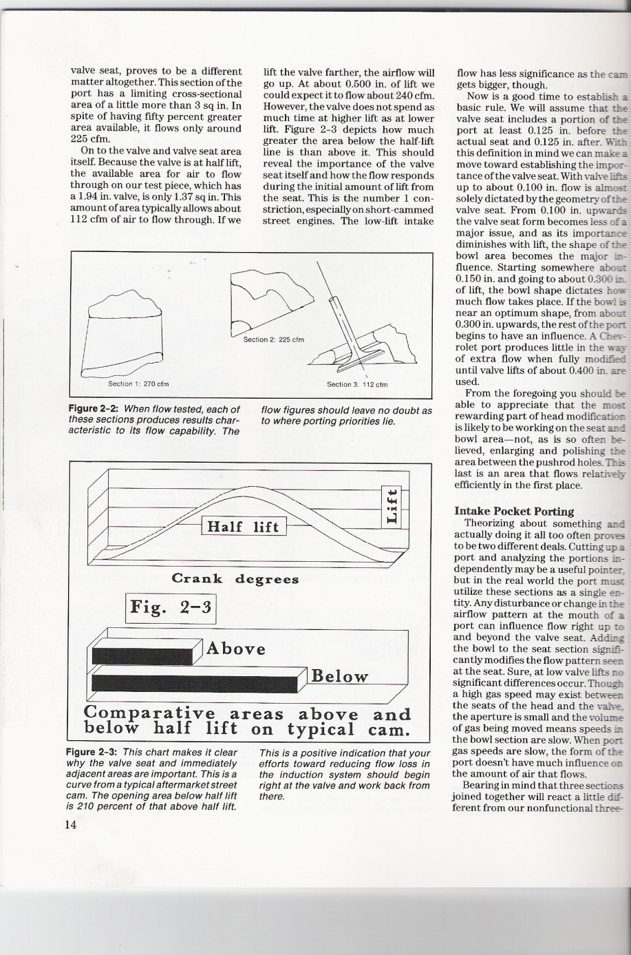

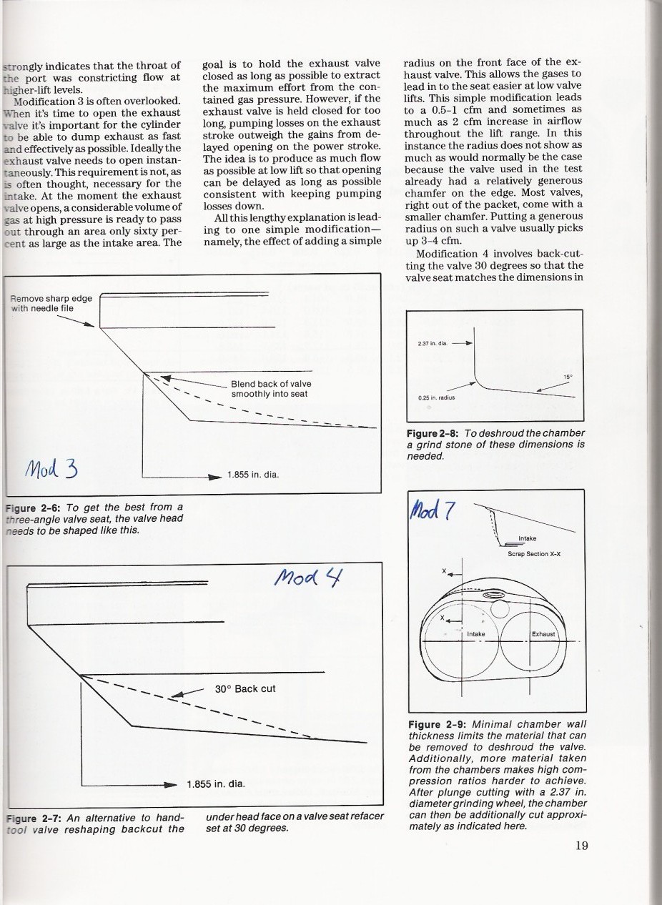

It's your lucky day, I recently scanned a section of David Vizards "how to modify SBC cylinder heads", the section about home modifying valves for performance. Here ya go
link

The only thing to remember, is the valves seat area is the part that has to touch the valve seat on the head, so it must be the same angle, with no nicks, in order for it to seal ok. Aside from that area, the rest can be smoothed, ground and modified to suit. I think i'll chuck an old 1.84" valve up in a drill press and whip out the needle files and give these a shot...
Radius the margin at the faces of the intake valves (The far right example):
Among the short trackers around here (required to run factory castings and 2-barrels), the concensus is that this change alone is worth 5HP. I'm not sure how many CFM that may be, but the dyno doesn't lie.

The "back cut", where you either radius or at least reduce the discontinuity between the untouched portion of the back of the head and the ground face, makes a similar difference.
You'll likely find that a file is near about useless for that.
I like to use a diamond bit in a die grinder, with the valve spinning of course.

Vader, you are talking about the red arrow area here? I think vizard said something about a certain way to do that, or else it will cause reversion or something....? Or to chamfer it, but not radius it...?
Sofa, you are talking about the blue arrow? What about a sanding drum in a die grinder? Probably would work the same...

Yeah, I'm talking about both places; the red arrow, and the blue arrow. The red one is the margin, the blue is the "back cut".
A sanding drum is too coarse. It would be too hard to control. Also not really smooth enough; that is, instead of a nice smooth outer surface, it's lumpy, so it tends to leave divots and peaks instead of a fine smooth surface.
I've done margins before in a pinch with 400 grit sandpaper, lubed with ATF, just holding it on the valve margin with my finger, and that didn't work too bad; kind of burnt my finger a little bit though, and went through a bunch of sandpaper, by the time I finished a whole set of valves.

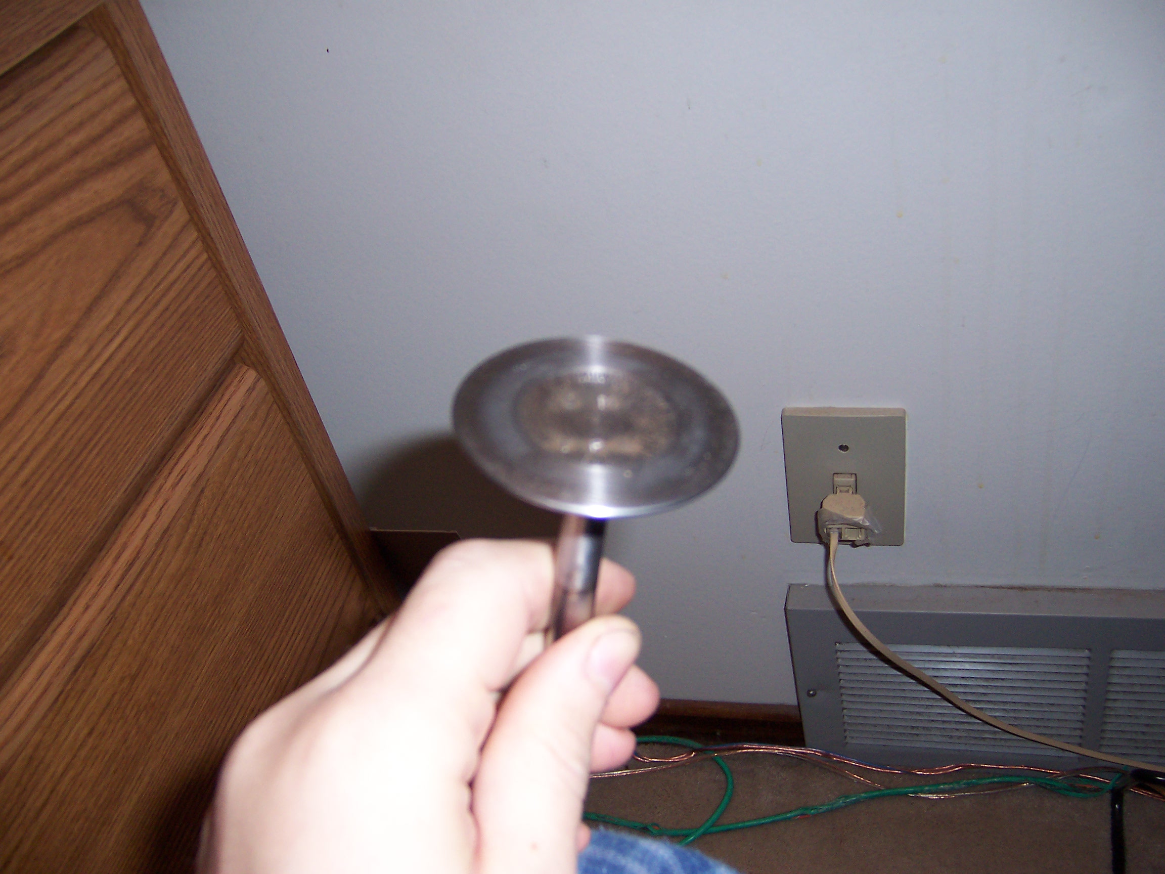

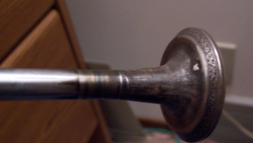

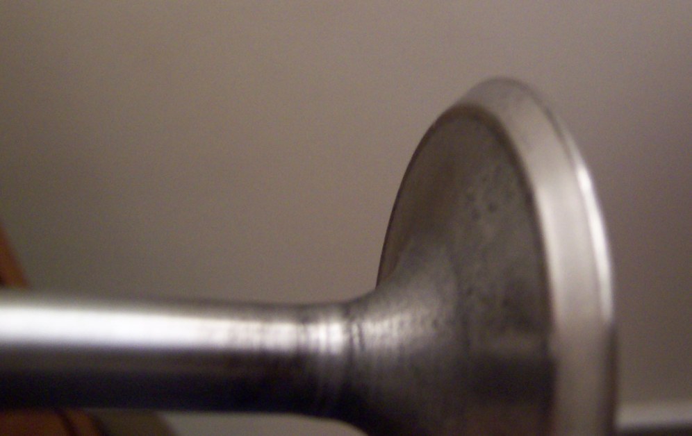

I got the valves from the 993 heads I practiced porting on. The valves are "scalloped" on the underside, and are in decently good shape. The ones off my 416 heads, are flat bottomed, and have ROUGH valve sealing surfaces:
1.50 exhaust
here's what I mean, scalloped:
pic
what's the deal on that? good thing, bad thing?
scalloped and flat valves
exhaust valve think the valve seat is bad enough on the exhausts to have to toss them out? I would think so...

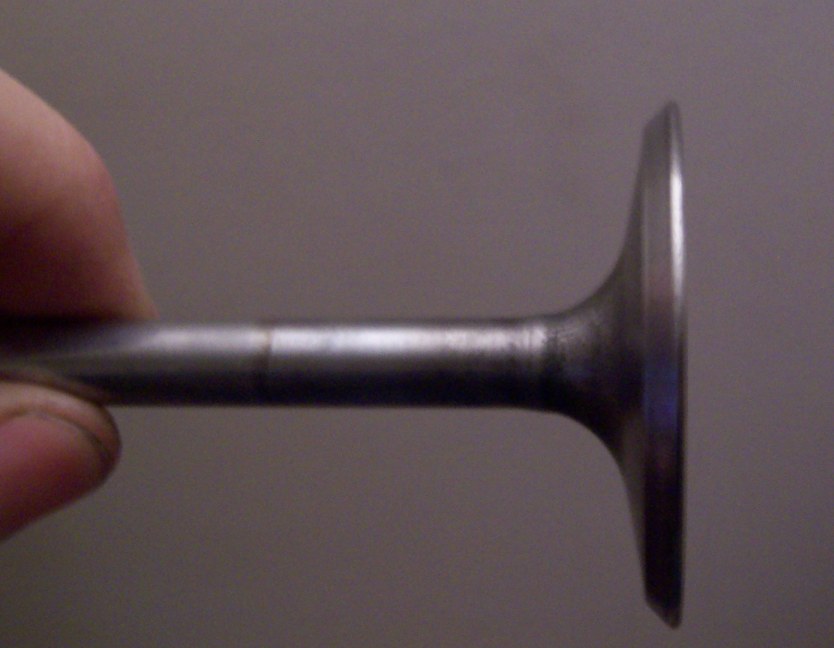

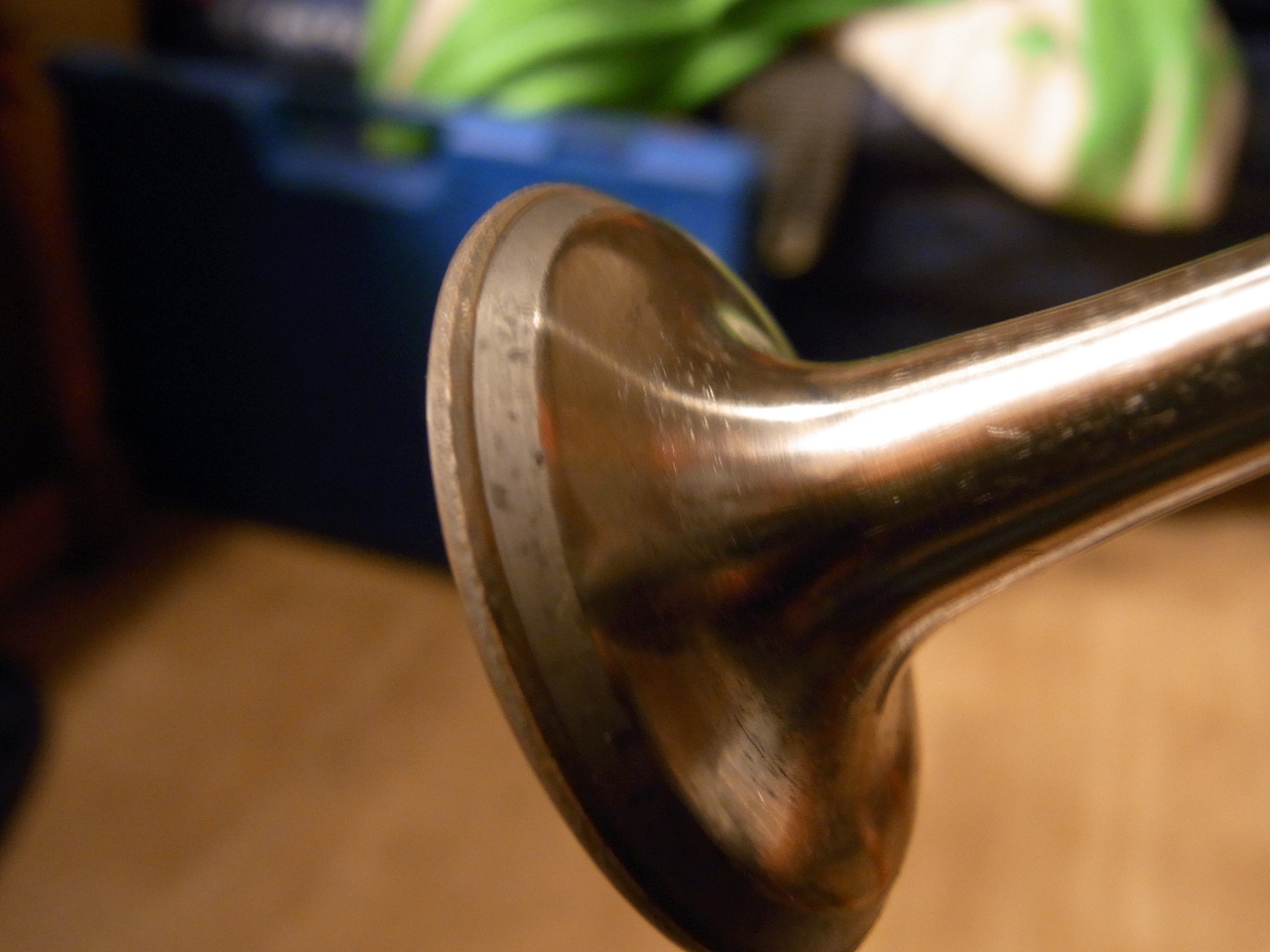

intake
back of intake
I did this according to vizards write up in
link and what i've heard on these boards. Apparently a radius on the front margin, is good for the exhaust valve in particular. Radiusing, or chamfering, the back ridge, is also a good idea, and knocking down the green arrowed spot in that one pic of mine, was also mentioned.
I used 50/80/120/180/220/320/600 grit sandpaper, and a maroon scotch brite pad. I finished it with autosol metal polish, on a piece of paper towel. I used a file to knock off the sharp edges, and chamfer it a bit, then the paper to smooth things out, and finally polish. I can post a "before" pic if desired. I've finished a handful of valves so far. I think i'll grind the chamber side of the valve to be perfectly smooth, and polish that to a chrome style of finish.
Any thoughts? This look good so far?

ahem, ok sofa, I think I understand you now.
I used a file on the intake valve, radiused the back of the valve seat into the back of the valve. (a back cut).
then did a chamfer on the front face.
According to vizard, you want to radius the exhaust front edge, but chamfer the intake, as it prevents cammy-ness (mildy i'd guess).
HOWEVER! The exhaust valve is much harder then the intake, and after trying to use the file on an exhaust valve, I realized I had flattened the teeth on my file.... hmm.
A word to the wise, beware of destroying your files.

That article you linked to is basically what I did (except for the "powre ringz".) The power rings sound like an alright idea, give them a try eh?
The sandpaper, and dremel while spinning the valve in a drill press is what I had to do though. Keep in mind what I noted above, exhaust valves are SUPER hard...

Scans from the book;

Last of the book scans

Thank you Sonix. Those pictures are exactly what I've been looking for. Now to rig my drill in a vertical manner...
Thanks again

It'll go quick if you also use a die grinder with a sanding cartridge roll mounted, and then later a scotchbrite/sanding flapper wheel for finishing. You will then need to get the 45* retouched.
Here's some pictures of modified valves:

Note: The valves in the photos I posted are LS1 valves and already have an efficient shape and a factory 30* back-cut on the intake valve.
SBC1 valves require more grinding to get a superior shape, but they come out almost as well as the LSX valves.

Here's some pics of radiused exhaust valves.
