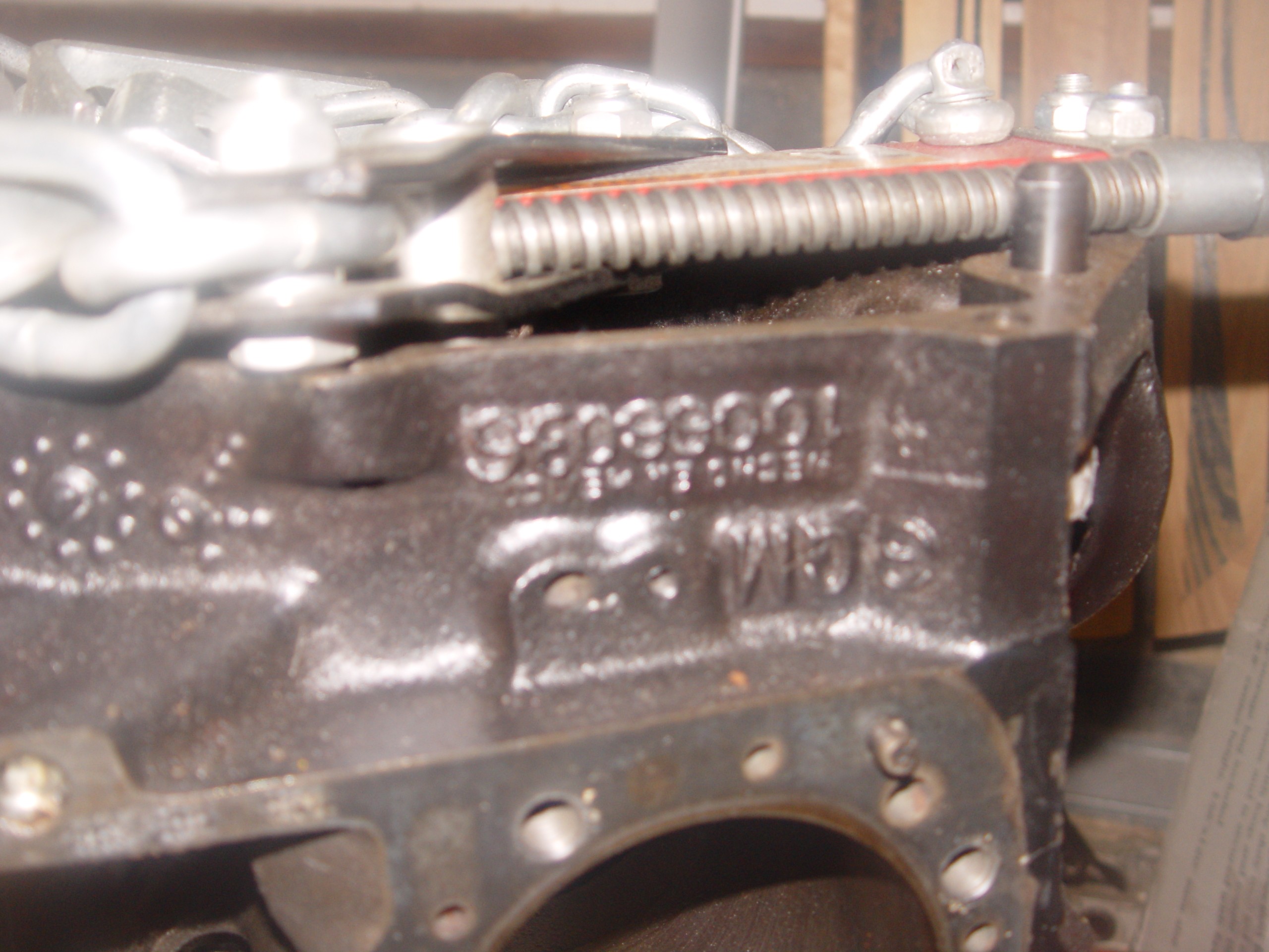

The 3 digit number on the side of the block, is that the last 3 digits from the casting number?..I saw "808" on both sides of the engine. What does that mean?
Old Jun 28, 2010 | 05:59 AM
  #110
RyanEricW's Avatar
Joined: Jun 2010
Posts: 298
Re: What kind of Edelbrock engine is this?
Not sure what that means, but I know that is not the number you need. I've been told by a lot of people it is on the driver side, rear of the motor (up by the firewall). I am sure he just typo'd. Your number will be something like the number the guy mentioned in the post below.
Not to make you worried by I have yet been able to see my engine code, it is really hard to find it, as it is pretty far down there I think, and my engine is probably dirty back there. I tried a bending telescopic mirror and light to no avail...but then again the engine was hot and didnt want to get too close! Lol
Guy sold me my car said it was a 350, but I have honestly doubted it since I seen the car. Mine is probably a 305 honestly... I have a written contract and even saved the CL ad in case he lied I can take matters from there. I don't like people who lie about things to sell it.
3970010 back of block driver side

Check this site for the locations of casting numbers:
http://www.chevy-camaro.com/chevy-ca...oding-help.asp
You can go to www.mortec.com and do the command "ctrl+f" (find on your keyboard) and type in your casting number and it should show you what motor you have. I believe I did this with my block, but I don't remember the number.

I found another site that may be useful that lists some block casting numbers.
Zachkuby, your casting number came up with this:
1968 - 3970010 - 327
1969-79 - 3970010 - 350 - car, truck, Vette
Heres that site if Mortec isnt working:

And this is the main reason getting the number off the block isnt going to tell you much. They used the same block for a lot of different cars. The head casting number is still the best way to tell what that engine is.

Originally Posted by RyanEricW
I thought the numbers were on the driver side of the block at the back? Lol
My bad, I shouold have said drivers side.
To the original poster, heres what your looking for:
