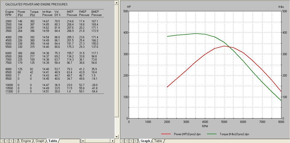

Here's a estimate from DD2000 for your setup. It's obviously not exact but it will give you a good idea of where your motor will be at. All numbers are flywheel rated.
I just wanted to warn about the T5 before. If you drive it right you shouldn't have any unusual problems. It always isn't 1st that is the problem either, watch those 1-2 shifts and keep them clean when you have your foot in it.

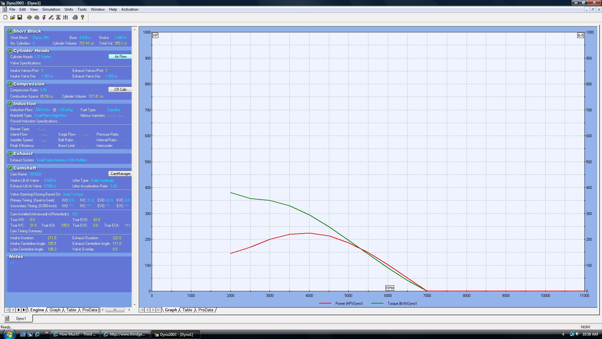

okay here is the XR262 specs manually entered with plain jane vortecs and small headers...
XR262 isnt helping at all

SpitotRS305 your numbers are way off. It looks like you have it setup as seat to seat timing on the cam but entered the duration @ .5. This is a flat tappet block too so no roller.

no that cam was entered properly comp only gives timing @.006 you need to enter the duration @.05 and the lift so that DD can calculate based on the IVO/IVC events
it was just the wrong cam
It's configured wrong it's set to seat to seat valve opening/closing timing so duration should be entered as the cams advertised duration.
A Vortec headed 350 and a XR262 are going to make loads more HP then 215ish with that setup. It would make more HP then that a LG4 cam.

you do understand that DD2003 is calculating that duration @.05 based on valve events...
Here is another example.. a stock cam file from DD2003
you might notice that the grind number is the same as the XE262
but wait the durations are that advertised oh no....
it only reports the .050 duration because that is what is actually important
But also note that you have it setup right this time and that "valve opening/closing based on:" is set to .050-inch and not seat to seat like it was erroneously entered in the first calculation. In the previous image you can clearly see it's not calculating .050-inch lift at all, it's stared out, and it's thinking that 211 is the advertised duration.
Just use logic the flat tappet cam of same duration and lift is making loads more power then the roller cam according to your calculations. Something is off and that is all that I can tell.

okay this is a very simple concept...
when desktopdyno goes to calculate a cam it needs
1 the advertised duration
2 the intake centerline
3 the cam lobe center angle
4 the lift at the valve with the assumption of 1.5 rockers
now if you know all of those and also know that the cam manager in DD is setup with compcams grinds in mind you set your ramp rate to 3.0 for the flat tappet
now it will calculate your seat to seat valve timings almost perfect for comps grinds
the only reason to need the .050 numbers is to calculate ramp rate properly however a perfect ramp rate calculation isnt very important 3-4HP at most
here is the XE262 again where the secondary .050 numbers arent used instead i let DD do the math and guess what pretty damn close...
the problem with my first run was the fact that the XR262 is a VERY VERY different cam so EXTREMELY different that it isnt even a chevy grind... think Chrysler
and DD2003 doesnt do neg. degrees very well
