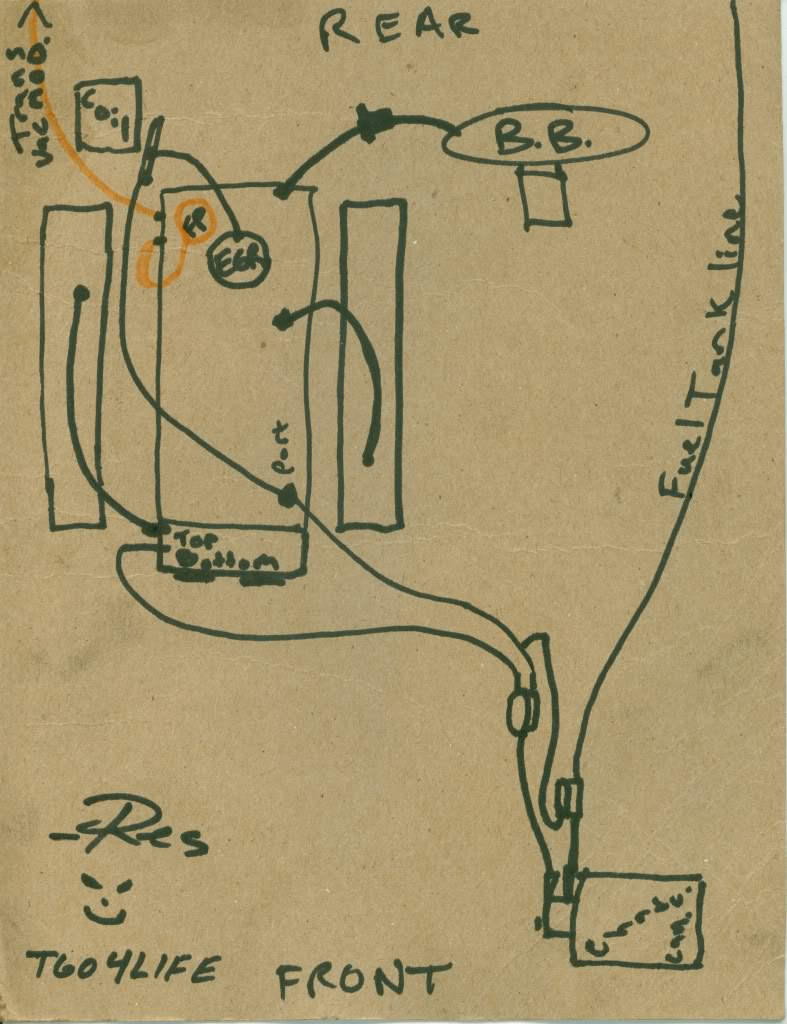

In addition the info. below, I am going to make a diagram tonight to aid with this that will show my Vac. hose routing.

No AC, No Heat, No Cruise Control, No Vac Globe on driver side. No Smog but EGR is still in place.
