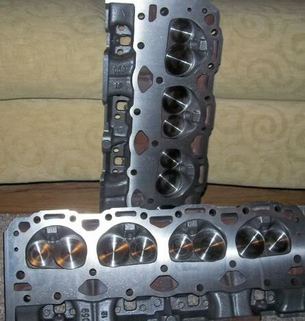

I'm stunned! I am sad that I've not heard of these heads before now. I just now checked, they're not on the Brodix website, not even in the new products area. How the hell are we supposed to benefit if they're gonna keep them a secret? We are 99% of the market. No, nobody tell them this. They're not worthy of our business. We should just stick to what we've been using.
If anyone here wants 435 HP and 6500 rpm, the TFS 175 heads can get you there. They're at least decent enough to get their heads in the magazines and on Summit's website, as well as their own.

I know right! WTF?! Brodix is too good to just "ignore" so I called French Grimes, the guy who get's them DIRECTLY from Brodix.
They are an aluminum 23* head
Stainless 1.94/1.60 valves 170-175cc
Flow Figures are 220@.500" intake 170@.500 exhaust 28" h2o
They have tool steel springs set up for .550 max lift
63cc chambers, with a steel shim head gasket expect 9.5:1 - 9.7:1
They also have heat risers and if you want a set you have to let him know they are for a street application. They will set you back $1235 complete ready to bolt on. Shipping is not included.
Mr. Grimes also states that they are 500hp capable. So with that said I think they are comparable to the TFS counter parts, and I wish we could get a set to look at (anyone need some 305/350 Brodix aluminum heads assembled?). You can call him at 540-923-4541.
Also if you look on some of the official pages and forums they do talk about using stock cranks and rods. I wouldnt for a race app. but thats just me. They say it works just fine.

My conversation with Mr. Grimes.
So I called him and told him I have interest, but I NEED flow figures. He said he WONT give them out. LISTEN WHY.
You have to understand racing is very secretive, the Racesaver head is a spec'd head. Meaning it is made to be EXACT head from head for competitive racing. IF he gave out the flow figures he would be cutting his own throat because, he IS THE SOUL PROPRIETOR of Racesaver Racing and it would for sure cause racers to set their combinations up the same thus making better teams with more skill less competitive thus denying them of their rightful win. Not only that but flow figures vary from machine to machine and racers would complain about a bunk head, unrightfully...We all know cam size, timing, ramp rates etc all contribute to how much the will heads flow at a specific lift. The variance in between these engines are 40HP being as tight as the rules are. I understand that! Now if we buy a set, and flow them, thats no big deal. But he just cannot give out info to street guys he DOESNT give out to his racers. Period. It is up for each team (because this is REAL racing) to develop their own conclusions. Meaning this is SERIOUS BUSINESS, not some catalog head. He has an engineering degree, has been doing this for 50 years and has his own facility that develops these heads (and other racing parts) which he has thousands of hours into R&D for. He said he gave us more info about the lift at .500 than he has ever told anyone else (thank you Mr. Grimes). He said that he would tell me a few things.

MY ported 059 heads flow chart @ 28 in/h20 pressure drop
1.94/1.60" valves, Multi-angle valve job, average numbers from 3 cylinders
Lift-----Intake---Exhaust
.050------32------25
.100------65------60
.200-----130-----113
.300-----185-----157
.400-----218-----167
.500-----254-----175
3.08 geared van weighing in at about 5,500 lbs with driver..on slippery street tires
RT----.396
0060'--02.62
0330'--06.57 @ 59.73
0660'--09.82 @ 76.52
1000'--12.64 @ 88.78
1320'--14.63 @ 96.55

I would like to see some pictures of the BRODIX heads too.
Fast355 is that 059 pictured there before porting? I ask because the valve guide looks really meaty still. Do you have any pictures of the port work?
Aftermarket heads have their place IMO. Not everyone wants to port cylinder heads, and I can understand that. I can't agree with it but understand it, yes.

Some mild runner work, undercut 1.94/1.50" valves, and a mult-angle valve job.
Lift Intake Exhaust
.050 35.60 15.00
.100 72.40 47.00
.150 105.8 72.50
.200 133.4 98.00
.250 154.1 117.5
.300 180.6 137.0
.350 195.5 145.0
.400 209.3 153.0
.450 217.4 155.0
.500 224.3 157.0
