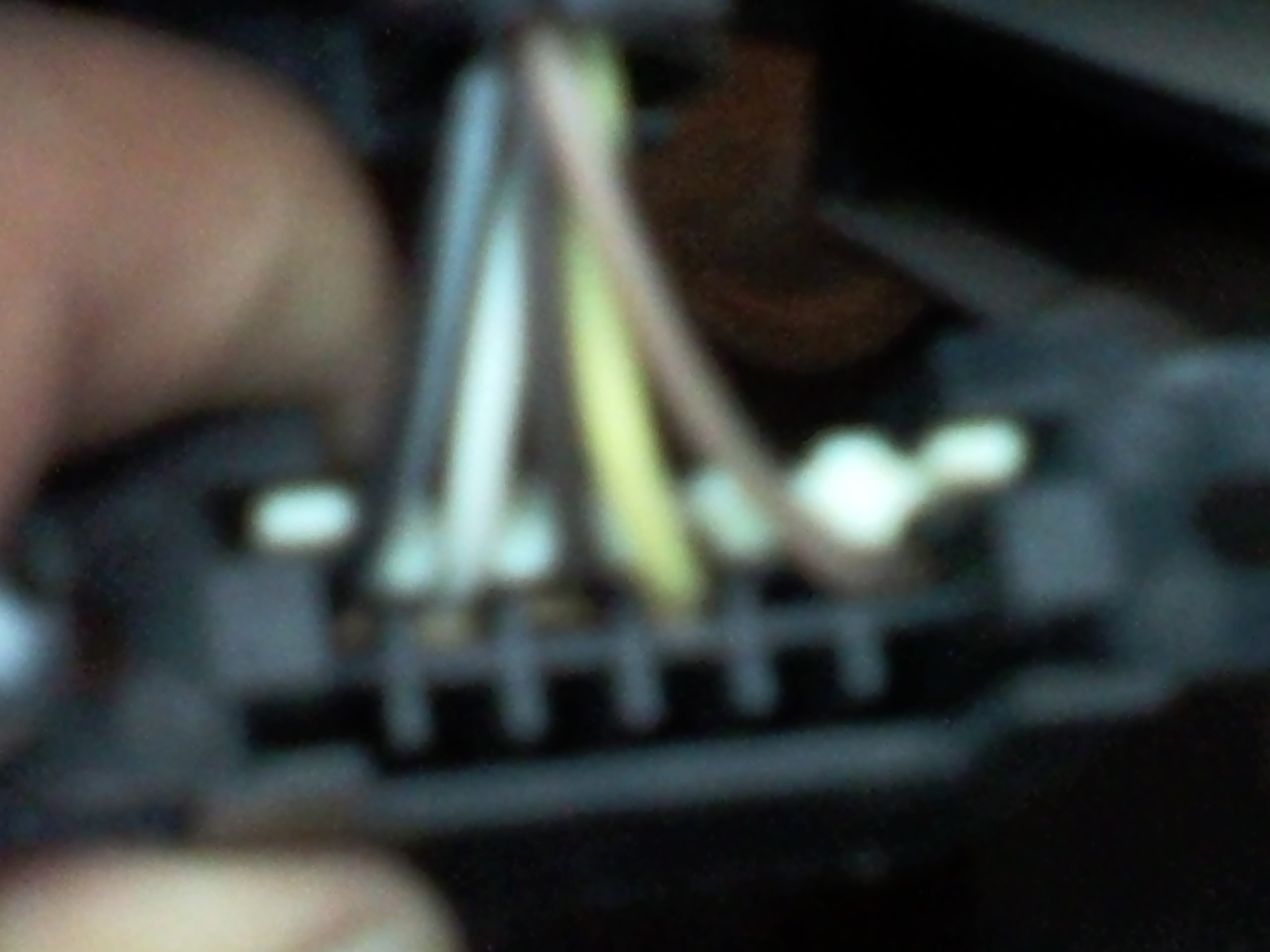

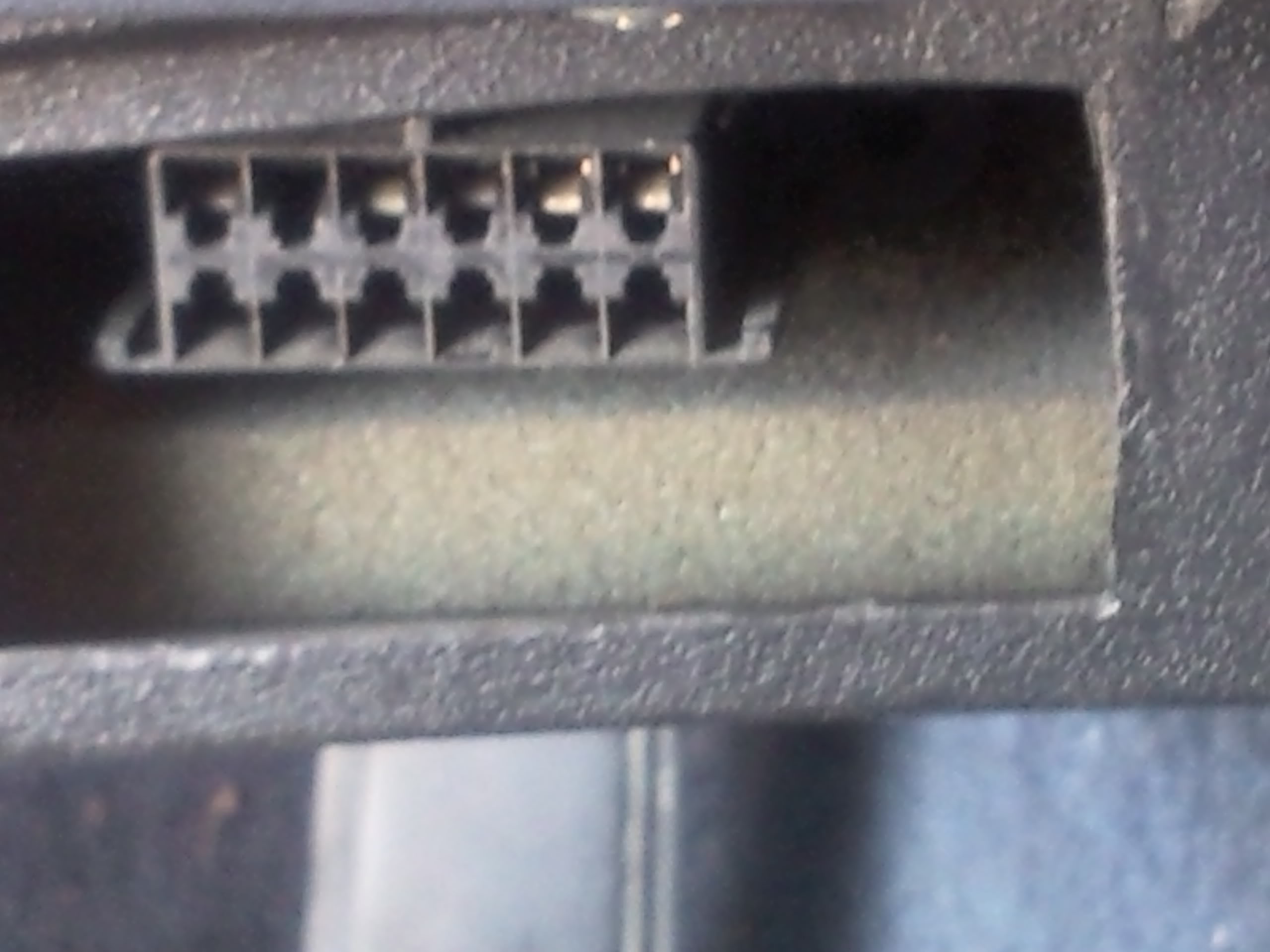

Old Sep 1, 2010 | 04:36 PM
berto85's Avatar
Joined: Aug 2010
Posts: 58
Re: Smog Test Fail, Please Help
Originally Posted by BluFBdy
id start looking into the possibility of a bad ecm, a solid light means youre not getting a reference code, normally this happens when the prom goes to crap, can you take a pic of the aldl port and show me where youre plugging in to? im not trying to be a douche but id rathercheck everything before telling you to hunt down a new ecm
here are the pics that I took, before and after putting the paper clip

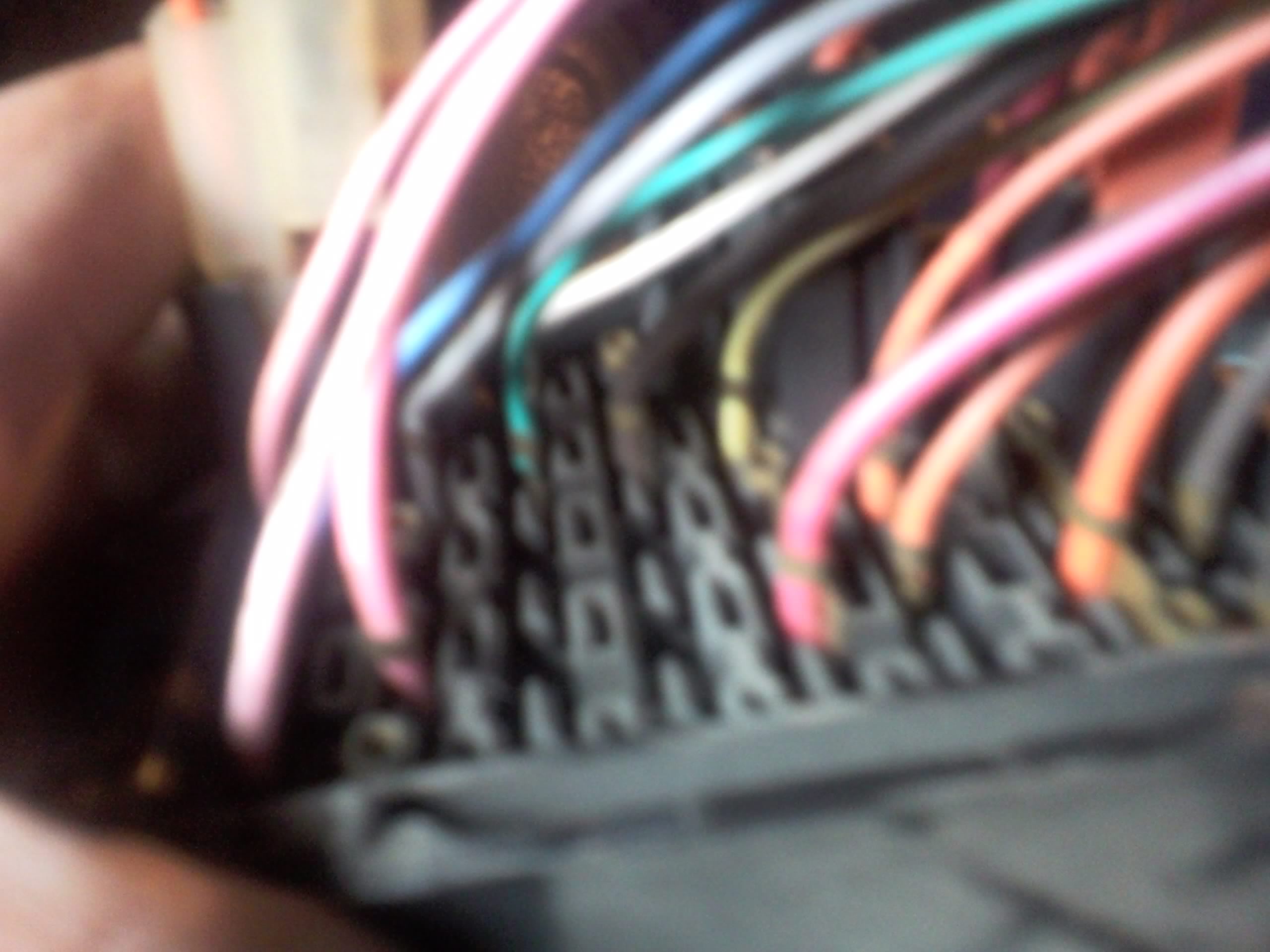

Old Sep 1, 2010 | 08:13 PM
berto85's Avatar
Joined: Aug 2010
Posts: 58
I also notice that I'm missing this fuses right here, would it matter to the perfomance of the car? Name:  SNC00036.jpg
Old Sep 1, 2010 | 08:59 PM
BluFBdy's Avatar
Joined: Sep 2007
Posts: 2,179
From: Port Orchard,WA
Car: 89 Camaro RS
Engine: 355 SD TPI
Transmission: WCT5
Axle/Gears: 3.08 Posi
...thats very odd, youre definitely missing a few fuses.... did someone do a hackjob on your harness?
and 2bfeard; he may reduce his numbers putting on a new cat but he will STILL fail for his check engine light regardless, the damn thing could put out lower numbers than a prius but it wont matter. Fact of the matter is there is a serious issue that needs to be addressed, a boo boo sticker isnt gonna fix this one.
Berto id suggest getting your computer looked at to start with, the paper clip looks like its in the right spot and im assuming you pushed it in far enough so the next step is gonna be checking your connections at the ECM and getting it tested. A solid light is either from user error or from a junk ECM. IF you have a local yard id suggest finding a bird from the same year with the same motor, and swapping them out, as far as those fuses go.... im slightly confused maybe someone can chime in because i cant tell if theyve got pins in the slots or not, if theyre blank then oh well but if theres wires runnin to it youve got a rats nest to sort out
OH! and check all your fuses! i forgot to mention that, also make sure none of the lights in your gauge cluster are burnt out
This is the back of the fuse box, I can see or think that some cable are missing, am I right?
and this is the back of the ALDLName:  SNC00056.jpg
It is hard to tell. The photos are blurry. Anyway. Does the check engine light come on when you start the car? If so does it stay on?

Originally Posted by berto85
could this affect my emissions? the carburetor base gasket, is an electronic gasket
I've never heard of an electronic gasket. Can/will you take a picture of your engine and identify the wires near the carb that are cut? If you are running an electronic Qjet (which I will assume you are), then it's a good possibility that many of those wires need to be fixed.
Second, in the picture you took with the fuse box, upper left hand corner is an "ECM" fuse. pull it out and see if it's good. If the fuse is bad, your ECM won't run run at all to control the timing or anything. This will also cause your check engine light to stay on and will make you unable to pull codes. I put a 15amp fuse in it because it's all I had but I've not had any problems since. (Pulling the 4-pack connector will blow even a 20 amp fuse if the car is on). Lastly, if you pulled the 4 wire connector to set your timing without first turning the car "off", this fuse WILL blow...I went through 4 before I figured it out.
If the fuse is good, disconnect the battery for 10 min. This will reset the ECM. If the ECM is STILL on after this, then I would definitely say you probably have a bad ECM.
On the next note, I would hazzard to guess that you're Qjet isn't tuned properly. If you look in the carb forum under "Dwell--It's greek to me"...it's a thread I had about checking the dwell on my carb...it's fairly long, but it's got basically the step by step instructions on how to tune your carb. If you want, PM me and we'll go through it that way.
