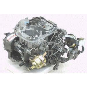

My Carburetor is a Varajet E2Se it looks like this Name:  93e0c0d5.jpg

Hmm it still doesn't make sense about the "electronic gasket" the only thing I've seen is on a powerstroke diesel its got the glowplug wiring built into the gasket, can you get more info on the carb?
that gasket they call it the EFE Heater Gasket
