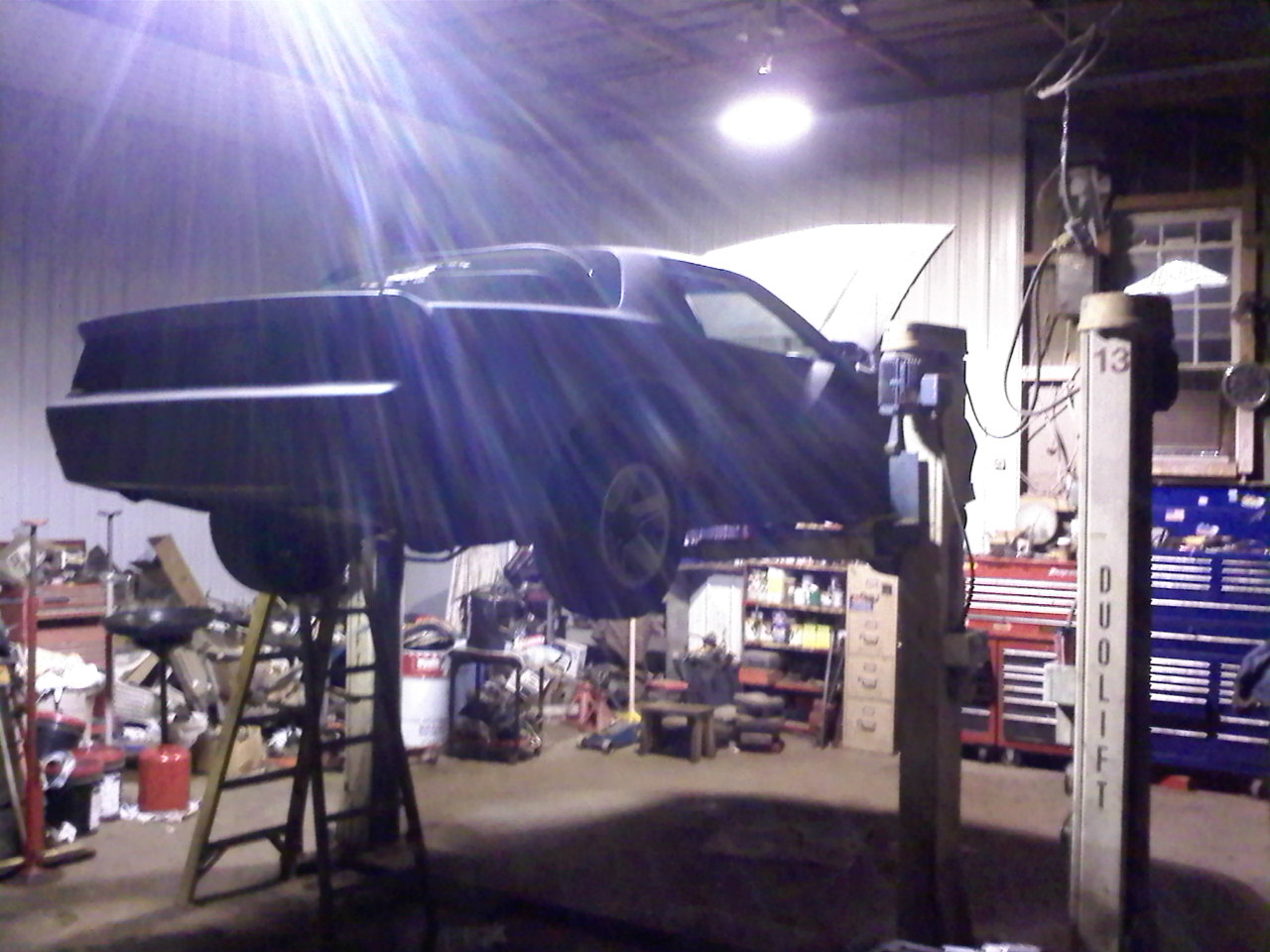

I am having problem wit 90 camaro rs , this problem has just started over the past year and I have been changing everything to fix it and just seem to get worse.I had to change timing belt ,egr, dist cap, rotor, o2 sensor,coolantsens,tps,cat,map,and fuel filter many other things lets start out with problem now ,will start fine will idle but cant drive , it first started out as I could not accelerate fast as car would bog down but let off gas it would come back up now I cant accel. at all wont go. trans shifts fine when running . also at times when you start it it idles ruff but other times its fine. I need help asap I have no more ideas. also I pulled codes and heres what they are. 33 MAP sensor circuit error (signal high indicating low vacuum),44 Oxygen sensor error (lean condition indicated),45 Oxygen sensor error (rich condition indicated) also new wires and plugs

ok so I went and just replaced the fuel pump myself (girl that is) and cleared codes drove it around a while and it seemed to do better , then while sitting rpms seemed low so just gave little gas to bump up, next I noticed car using a bit more gas (no leaks from work I did) went to accelerate more and car bogged again car now throws code 45 o2 rich any ideas this time

ok I threw it on a flatbed and towed it to the mech. him and another person from chevy are going to figure it out for me and will cost me min. I will get back to you on what he thinks also when I dropped off he got to hear how bad it is and seem like this will be a good challenge to him also, after all I changed all sensors even the map again and throttle checked all volts on it all and they are all right on. so give me a week and I will get back to you all. thanks so much for hanging in with me
