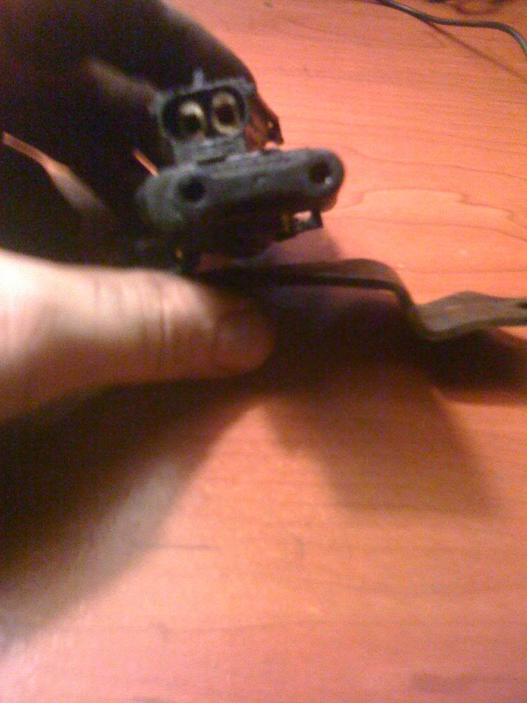

I tried looking for it in the engine bay near the windshield wiper motor. I have this sitting in my back porch. Is this what I was looking for? Or is it some EGR thing? I've got another bracket thing on the passenger side firewall that has a 3 wire connector going to it. is that the MAP? Im kinda confused..

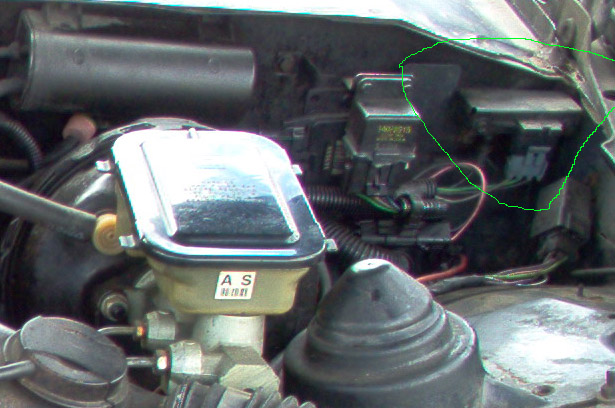

That looks like the egr solenoid to me. The MAP would be here:
You can faintly see the vac line going to it in this pic.

And the atmosphere pressure one would be here:

Okay I got it sorted out now. Thanks a lot man, I really appreciate it.
