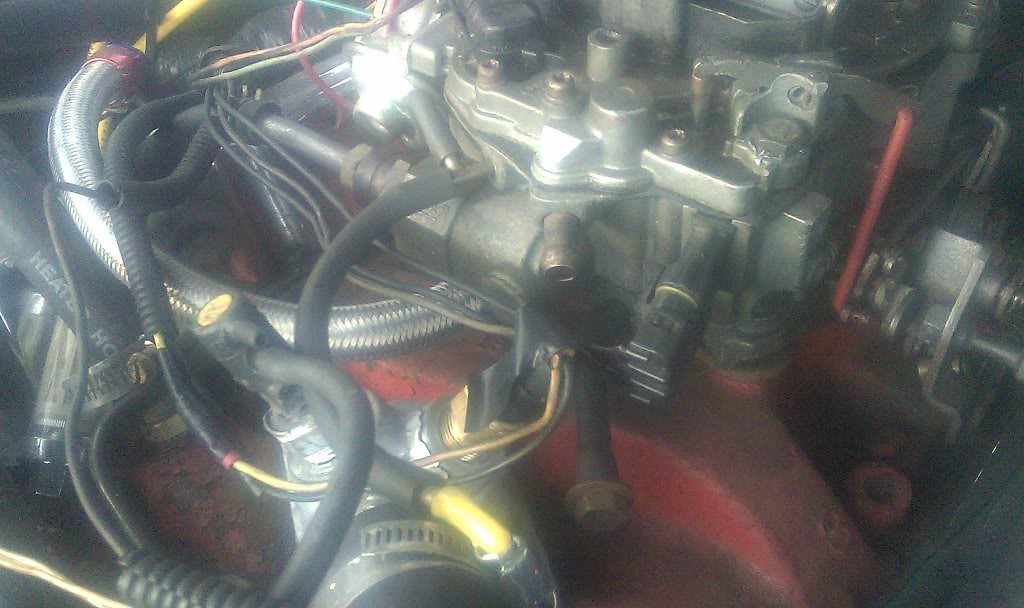

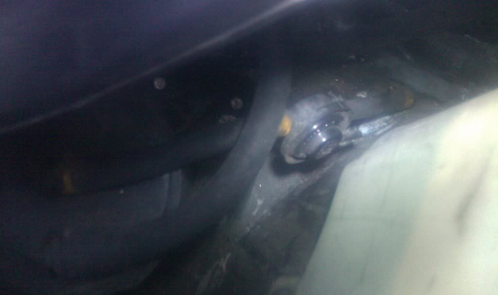

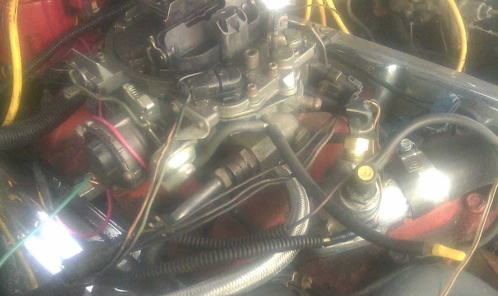

I'll just continue this post with another efficiency question:
How wrong are my vaccum lines?
I don't know what that thermal switch is supposed to connect to.
I have no emmissions stuff. Also, the line from the canister is just sitting there.

The TVS on the water neck controls the EFE valve that was in the pass side exhaust. You don't need it now and can plug the opening. No reason not to reconnect the charcoal canister, in fact I'd recommend it.
Oh and get a proper pigtail for that choke connection and a new one for your CTS.

Theres a sticker under the hod showing the proper routing of the hoses. Its hard for us to tell much from a couple pictures.
I dont like the look of that spring hose clamp on the gas line. Even if it is only 5-8psi on a carbed car, you should still have a proper screw type.

Ok, I'll leave the EFE there to plug it.
I don't know where to connect the charcoal canister. It has 1 tube coming out and on the end of it has like a second tube attached to it.
The choke connection is the proper spade. The green wire is my temporary rigged fan relay power. The CTS is a new pigtail, just that my stock carb cover hits it due to tilting from hitting the distributor. Rotating the dist is a project for another day.
I don't have a sticker anymore. The fan shroud is from the later serp model electric fan. The stick on the metal was painted over and destroyed.
I don't know why, but I trust the spring clamp more. I've had bad luck with screw ons loosening. I'll leave it at the moment, if it gives problems, I'll know why.
I can describe what is connected to what from this:
J: goes to the TVS, third pic
B: capped with yellow cap in first pic, supposed to be air cleaner? also separated to choke thing
L: PCV on pass valve cover
T: open, nothing connected
H: capped with tube and screws

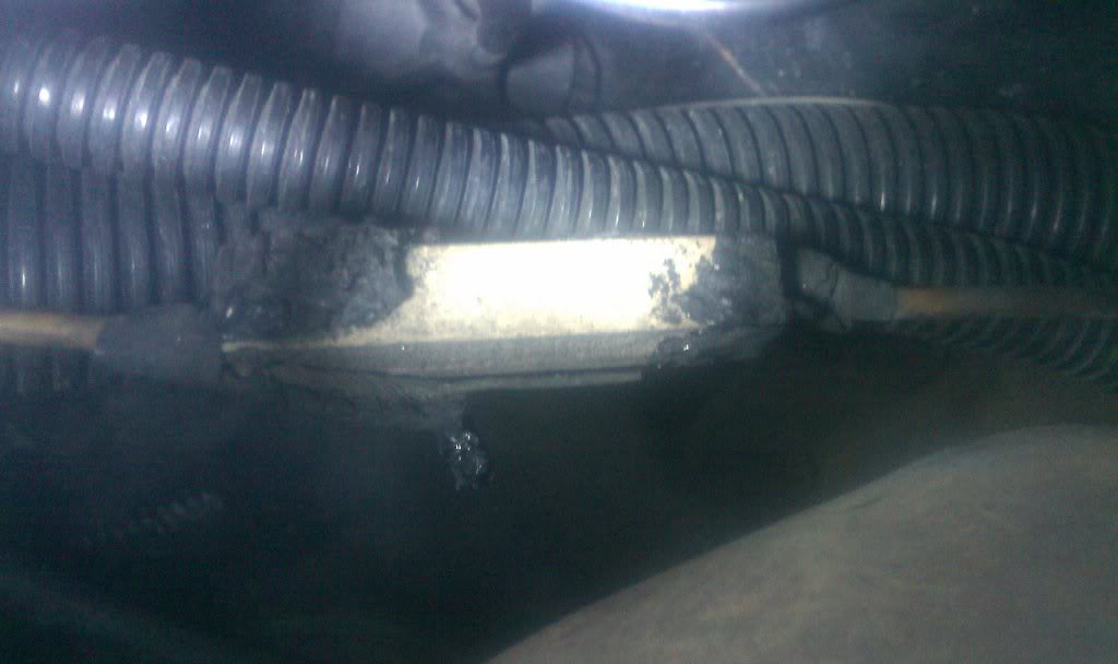

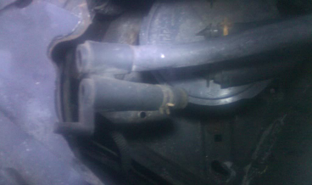

More pics:
That's the one tube coming from "to carb".
Thats from the fuel tank, no pipe on that little nipple.

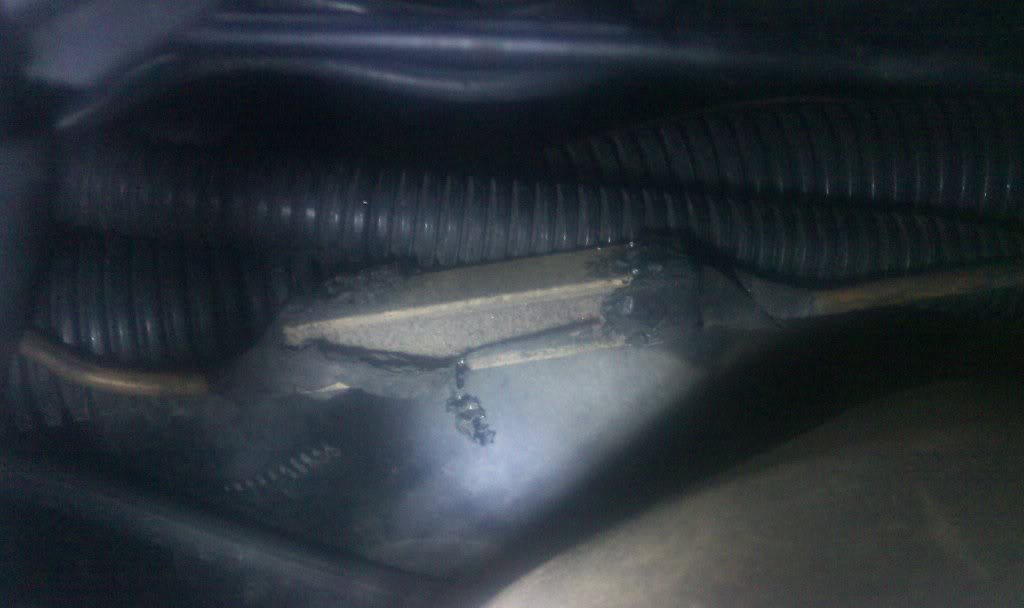

My tach pegs out when the car is on. With the key going from: car on - off - on(no start), the tach reads 0.
I found this coming off the distributor. It's the tach filter. I'm guessing that little wire thing is broken as it's just floating in air. Where do I get a replacement?

Ok, driving home from school, the light did NOT turn on. Before I left, I disconnected the negative lead for ~5 minutes. I did not read the codes after this point as the light didn't pop on. It should still be going off for not being able to tell vehicle speed (codes 24) since the speedo cable is disconnected. Weird. I'll still be installing the cable.
I really have to look into carb tuning. I don't have a clue as to how tweak the Idle Air Bleed. I know someone who has a dwell meter I can borrow. I'll have to learn how to use it though. Yes it is a 350 with headers running on the stock 305 setup carb.
I hope it's running better, it was making me fill up every 3 days. Pretty costly.
-Edit: If the Idle Air Bleed is the screw on top, then yeah I've spun it around. I just turned it to when it was a decent idle. Haven't touched it in a while. Didn't know the name fore it. The security cover is off of it.
So far, nothing is throwing a code pretaining to EGR. I hope it never does. This is the first time in like 20 years the car hasn't had a check engine light!

Check out the carb sticky on the E4ME and some older threads like this one:
https://www.thirdgen.org/forums/carb...its-greek.html
Post back with any Q's and we'll walk you through it.

Only special tool you may need is the driver for the idle mixture screws. Saw one at AZ not long ago for maybe $10. Has a flexible shaft and a handful of different shaped bits.
Don't worry about lean/rich stop settings. Measure the travel to ensure it's 1/8" (and that it's clicking up and down properly) then go to the IAB.
AND cap those vac lines before going any further..make sure none leak.

Ok, here's the down low. Got some things done today and a little update on before.
When I said back on the 16th that it was still giving code 13, well it stopped giving the code later that day. At that point only code 24 was popping up. I decided not to mess around with the carb just yet.
I had a long break between classes today, so I started working on the car in the lot. Took my Pioneer CD player out and hooked up an aux cable (finally!).
I also fixed a burned turn signal bulb. Popped the fuse while testing leads. When I looked at the fuse block, there were 2 other fuses blown. One was ctsy 20a, another inst light 5a, and the other was closest towards you, pass side 10a. The 5a wasn't blown, just melted. Strange.
I had the old speedo cable out laying in the engine bay only disconnected from the dash. I fed in the new cable through the firewall and connected it from under, through the hush panel (saves sooo much time vs taking gauges out). I spun the tranny end of the new cable and the speedo/odom/trip were moving. Awesome.
I come home and put the car on ramps. Removed the old cable. Found out it was still working. Spinning one end, spun the other. Although it did have a gash in it. There was tranny fluid on it. I popped the new cable on and took it for a spin. No luck.
Couple of things I noticed. I was able to spin the transmission socket where the cable hooks up. Is this supposed to happen? Also, the square on the transmission was a lot bigger than the speedo cable square. Is that right? The transmission was an electric speedo, I put the speedo gear stuff from my original tranny onto it. The tailshaft gear was red on my original tranny which I am pretty sure is the same as my current. What do you guys think it is?
After that, I rechecked my timing. I realized every time I was checking it, I had the 4-wire EST connected. Popped it off and checked where it was. 0*. Awesome. I capped any vaccuum port that wasn't being used. Had my brother help and we bumped it to 12* BTDC. Too much? Throttle response seems to be better, but I can't compare as I haven't driven my regular route. I don't know if starting will be a problem as it did hard start once.
I've noticed better gas mileage (before timing adjustment, don't know after timing). The gauge seems to be dropping slower. It was all going well, till today when I had a fuel leak from my mechanical block fuel pump. I'm running the bigger stlye that came with the 350 engine. The steering linkage hits the fuel line and tears it. I have the smaller original style Airtex to put on tomorrow.
Almost there...
Thanks a lot for all your help fellas.
Any suggestions/corrrectins for my speedo/timing?

Fixed the speedo. Had to remove the gear housing and reseat the gear. It reads high, so it'll have to be swapped down the road.
Fixed my air buldge solenoid. Works with vac now!
Have to see if my converter locks up now, see if the right voltages are going to the 4pin connector.
