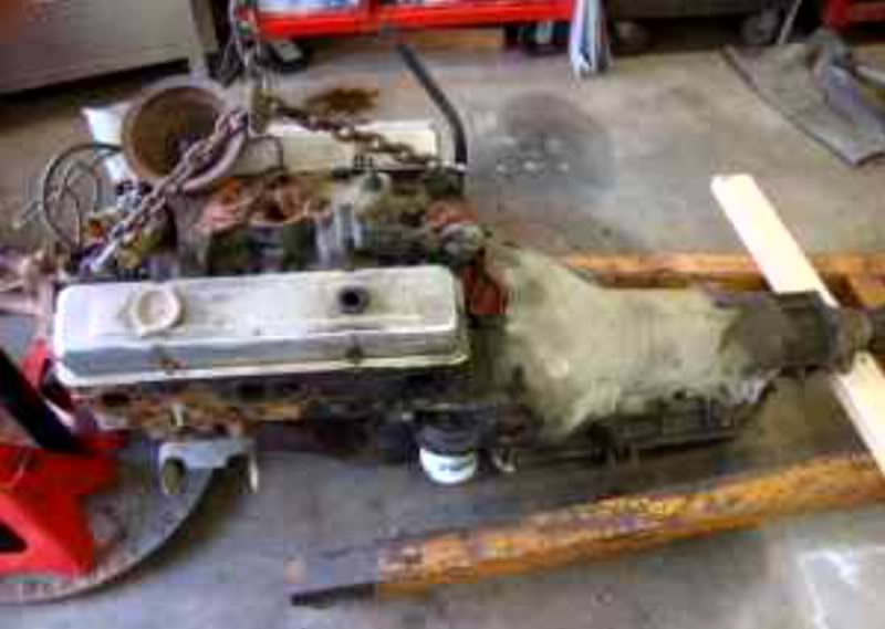

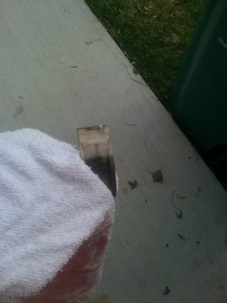

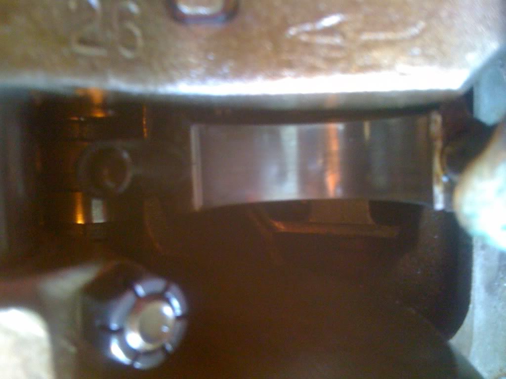

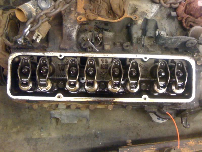

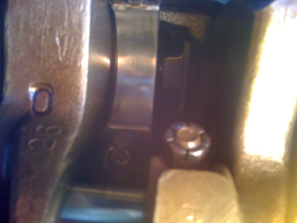

I just picked up a SBC 350 for my car the other day. I didn't get to hear the engine running but I kinda believe the guy saying it was a good engine & it looks to be in good working order. He said it was a Jasper rebuild & it had about 22,000 miles on it from the time it was put in til it was pulled. It had some kind of "Warranty void if removed" think stuck to one of the freeze plugs on the front. It spins freely & it looks clean under the valve covers when I pulled them off to inspect it except where they were leaking. The outside is a little oily from valve cover leaks & the intake looks old. The heads look like some type of aftermarket heads. Should I remove the heads or anything else to check everything out before I clean it up & install it into my car? What are the normal things you guys look at before dropping it in? I plan on doing a couple things...New gasket set, double roller timing chain... What else???

The front and rear main oil seals are a must, especially since the engine is already out. I would also do a pan gasket and maybe a new oil pump as long as your down there.
As for the heads, I would leave them unless you find low compression.
And if it was me I'd clean it up nice

based on the fact that the valve covers are not centerbolt im gonna say that your engine is 1986 or older... ill run the casting # to make sure
in that case you'd have a two piece rear main seal
as for the compression, if you find low compression id go for a rebuild (including machining)

dont crack open the top end unless you have to. it looks pretty well sealed up as it is, and if the guy wasnt lying, it only has 22k on the internals. did he mention if the cylinders were bored over or rehoned?
the heads look clean, go for a high volume oil pump, and if you want to sqeeze some extra juice out of the motor, get a set of FULL ROLLER rockerarms
if you check bearings, make sure you tork them back to spec.

The block is from a truck, 350, from 1980 - 1985.
Those heads look like World Products S/R Torquer heads - either going to be 67cc chambers or 76cc chambers, with 170cc runners. Can you get the casting number to us, can't see it clear enough in the pic.

The heads on the engine now can use perimeter or centerbolt valve covers
Here is the site where i found some info on them
http://www.worldcastings.com/product...ron-heads.html

I posted the link above. Are they anygood?

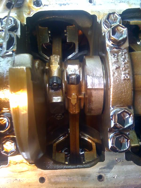

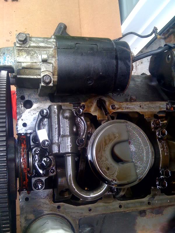

I was out in the garage yesterday messing around & decided to drain the oil, pull the pan off, & visually inspect things. I know that just looking at things doesn't mean anything but everything looks good from what I could see. The oil didn't have any metal shavings in it & the cylinders look good from what I could see. I rotated the crank so I could get a better look at each cylinder & I didn't notice any scratches or marks. It started storming & I threw everything back in the garage & locked it up. I didn't pull the main cap or check the front rod bearing yet... What should I do first... Should I pull it off the stand, put the pan back on, fill it with oil & do the compression test... or should I go ahead & check the bearings & replace those if they are worn any & throw a new rear seal on it then do the compression test?

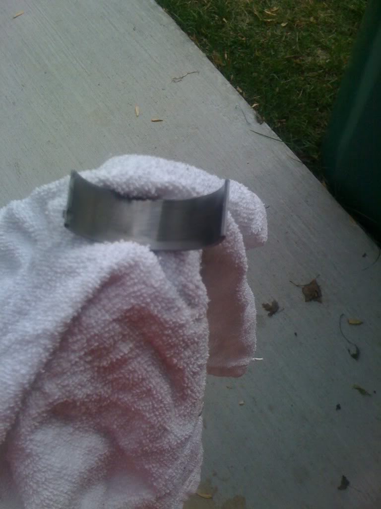

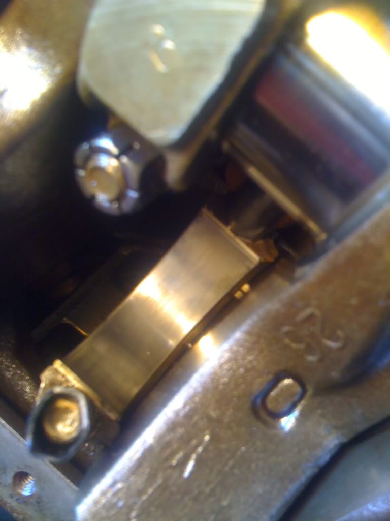

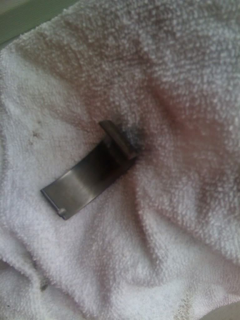

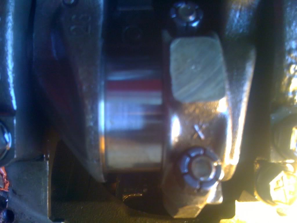

I finally pulled the front rod bearing today. It looks okay to me. The bearing that goes on the cap side looks a little more worn than the bearing on the other side but there is no grooves. I slid my fingernail across it & it's prettty smooth. It has .020 stamped on the bottom so I guess that means the bearings are over sized? The crank is smooth as a babys bottom too lol. I haven't pulled the front main cap yet.

Looks clean. The oversized bearings mean the crank was resurfaced confirming the rebuild you were told was done

Looks good. Seems like everyone basically got it. New seals, new gaskets, etc. Nice find though. I've been thinking about picking up a spare engine.
